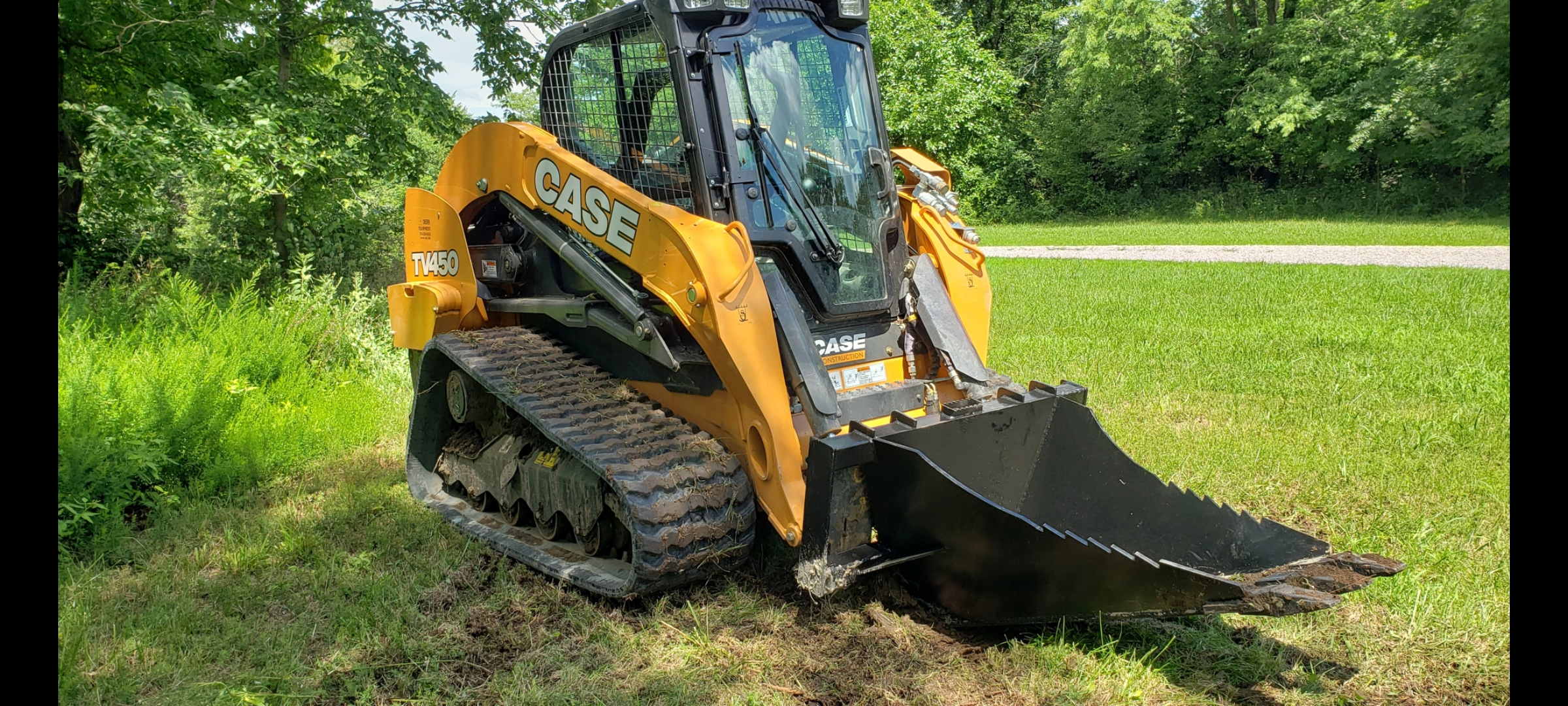

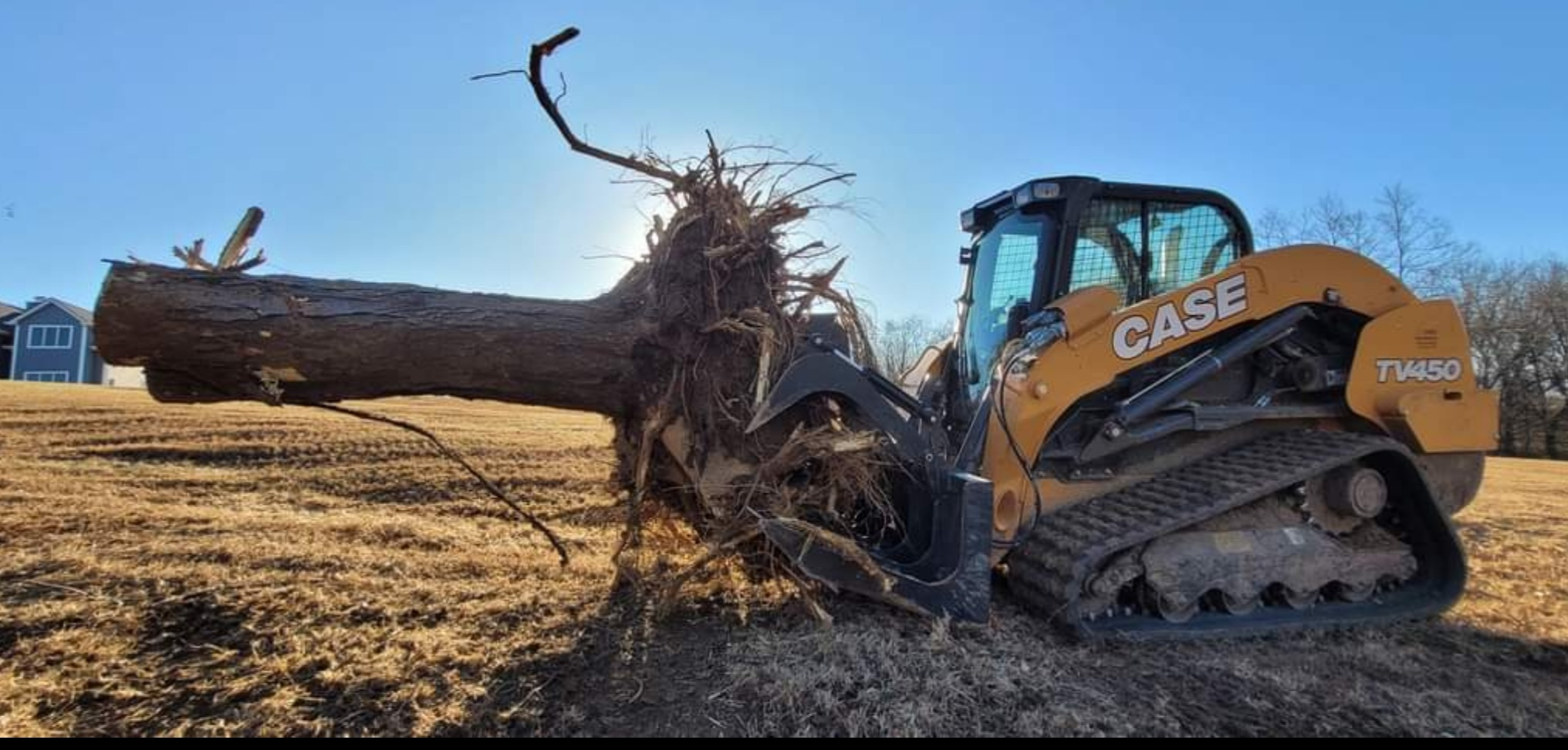

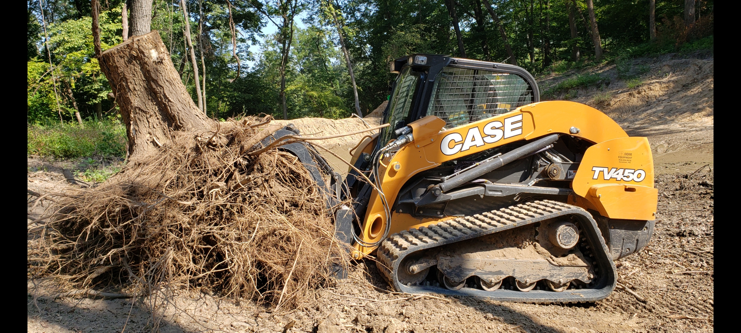

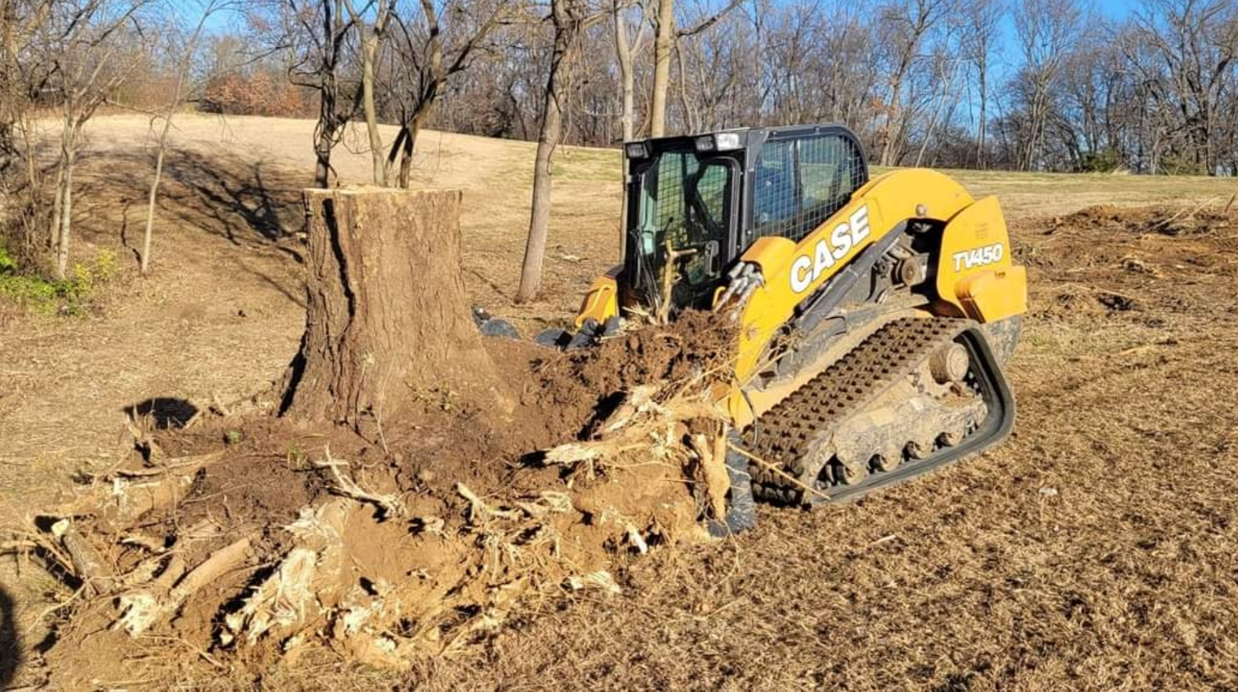

I'm taking a couple of big osage out today. Large track loader and stump bucket. Pics of a few big oaks I've removed. Hardest part about Osage can be clearing enough lower branches to dig around them. It makes for excellent fire wood also.
Edit: will add that if you are talking about a lot of them a large excavator with thumb would be my choice. Can easily dig them out and pile them using the thumb to pick them up.
