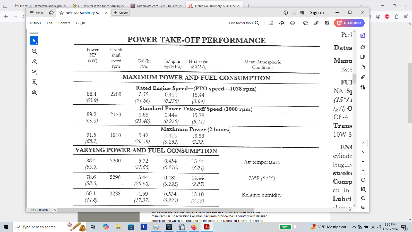

If your under a 100 hp tractor is using 10-12 gallons per hour of fuel it needs to be checked out for some serious problems. If your burning even 4 gallons per hour at full load thats high.
In the Nebraska test an IH 1066 at max power (125 Hp) and full rated rpm was 8.4 gph'
slowed down to pto speed and 119 Hp it was down to 7.3 gph.

She is a thirsty thing then, so your 33 gallon tank is only good for 3 hours of work?
And at 60% power on a 100 hp tractor if you are using more then 4 gph that is quite thirsty.
Now if that was 8 liters or 2 gph on a common rail injected engine it's good.
Heck my NH 8160 with it's 456 cubic inch mechanical injection 6 cylinder isn't that thirsty;
under 6 gph at 88 horse on the pto. Which is well over 100 hp on the engine.

No I wasn't mistaken the IH 1066 was a thirsty tractor but at 119 pto hp it was using 7.3 gph,
so if an 100 engine hp or 88 pto hp tractor is using 10-12 gph it is high.
My 88 hp pto tractor is well under 6 gph. And she is mechanical injected while I would expect that the TYM is common rail which usually gets better fuel economy.
