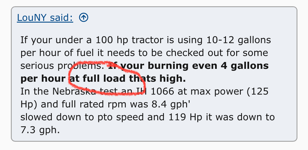

I don't think he realized that my tym 1003 is 100hp. He may have thought TYM models are simular to JDs numbering schemes - maybe he thought it was a 30hp. As I responded to him, specs show the 1003 runs 8gph @ 60% pto. If the specs are correct, which I have no reason to believe they aren't, 10-12gph would not seem unrealistic at full power.
No big deal, we all have opinions.
My 75 hp skid steer burns around 2 gallon an hour maybe 2.5 gallons. My second skid steer is 90 hp. I’ve not put enough time on it to really get a gauge of fuel efficiency but I know the 25 gallon tank put in a solid days work probably over a day. My dozer has a 3306 cat in it and was designed in a period when pushing dirt was the most important factor. I’ve never really measured its fuel burn but I know the 50 gallon tank last over 5 hours. A 100 hp burning 10 gph seems grossly inaccurate. A semi could make the proposed 43 mile drive with on the high side 9 gallons of fuel. That’s not even 5 mpg. If it gets a more likely 7.5 mpg it would take a little over 5 gallons. Are you claiming your tractor gets not even 2 mpg?

No I wasn't mistaken the IH 1066 was a thirsty tractor but at 119 pto hp it was using 7.3 gph,
so if an 100 engine hp or 88 pto hp tractor is using 10-12 gph it is high.
My 88 hp pto tractor is well under 6 gph. And she is mechanical injected while I would expect that the TYM is common rail which usually gets better fuel economy.
This is exactly what you said, that I commented on.
Your own data implies 4 gallons an hour would be quite good for a 99 hp tractor at full load.
   / How far is too far for driving tractor on the road? #139
It would be OK, for a 100 pto hp high but OK. That TYM is only 80 pto hp on a common rail injection engine that would be very high it should be much less. So yes that 80 hp TYM shouldn't be using any where near 10 gpm 4 would be realistic. A new common rail injection engine should generate much better hp\gal\hr numbers then an older style mechanical injected engine. So anything over 4 gallons per hour would be high.
