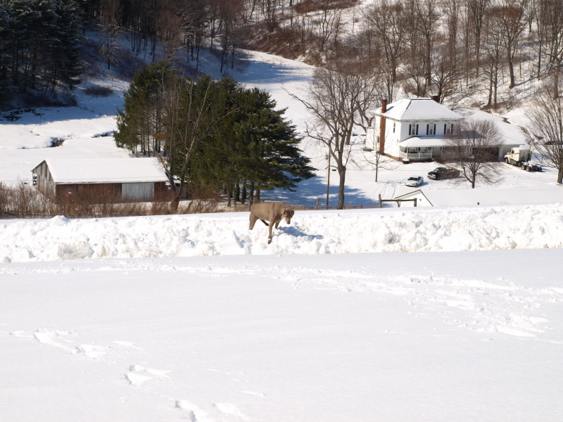

Sage advice for flatlanders. I don't have the luxury of avoiding slopes. The first pic is my side yard, the 2nd shows the drop in my front...:eek:
