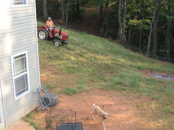

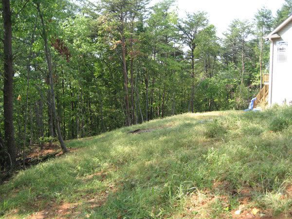

I'm new here and to tractors. Here's a few photos of some of what I've got to mow. I do them straight up and down. What are some of your opinions?
   / How Far is Too Far?? #36
Up and down looks like the safest way to go. Your slopes are pretty steep and just as important, they appear to have quite a few "bumps" on them (especially in the first picture).
It also appears you've got a nice turn around area, at least at the bottom (can't see the top).
This is definitely not an area to mow if that lawn is the least bit wet! You'll either have an exciting ride down or you'll tear the lawn up.

   / How Far is Too Far?? #38
Spiveyman, I have read that thread several times. Enjoyed it.
Roy, thanks for the tip. Wet=Bad :D Just at the top is my level driveway, so I do have good turnaround at top.
It is a little bumpy, but boxblade will help that.

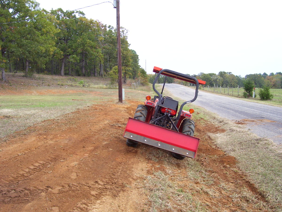

You have to remember those road crews mow on these thngs all day evry day. They learn/know/understand the limits of what they can do. Plus the wheels are usually pretty far out.
I posted these pictures a while back, some said it was beyond their pucker factor. But after a couple weeks of mowing I don't give it a second thought. I just hold on and mow.
BTW, in the second pic you can see the first time I stuck my tractor. See the dirt in the road. I was going down the bank towards the road, the BB got hung up on the bank. 4wd ATV left the black marks. Had to get the truck, that's why the chain is on the brush guard. :D
