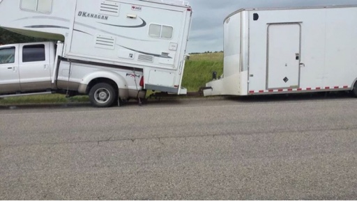

Maybe somebody ran into the back of the trailer?🤷*♂️
/ How is this possible? #22
If that were the case, why is the cab all jacked up in the rear? If it were just the bed, the cab would still be level and you could see the frame under the bed.
But to Eddie's point, I saw that and was scratching my head. I would have thought the extender used on the hitch would have given way long before the frame of the truck. We have friends that have a similar set-up, except a SRW 350. They have the truck camper that sticks out, use a 4' hitch extension, and tow a small stock trailer with Nigerian Dwarf goats. Not all that heavy and it scares me because of the extension.
At closer look, it does look bent frame is the problem, but I have no idea how that could happen. I have loaded 1/2 ton trucks so heavy that the front steering is light and never bent a frame. I can lift the rear of my truck off the ground loading my TLB on the trailer and not hurt the frame on my Chevy Z71. I can only think that the frame must have been weakened somehow by rust or something the owner did to it to mount the camper. That looks like a standard cabover camper so that should not have an impact on the truck frame.
The springs should have collapsed and bumper dragged the ground prior to frame breaking.

Like someone else said, the trailer is towed off the camper and it just levered up so hard it bent/broke the frame.
/ How is this possible? #27
Unless the Ford 450s share a ranger frame there’s no way that happened.

I have a friend who trains bird (duck) dogs. He has a special stainless box built for the back of his 1 ton that can hold a dozen dogs, water, food, and all the other supplies he needs. He travels all over the country so it also has a place for him to sleep in it. It's heavy enough so it has to go on a dually. I can't remember which brand it was at the time but about a year after he bought it the dealer had to do warranty work on it. When they lifted it up they bent the frame just like that because they placed the lift arm further forward of the axle. They were upset at what had happened and called him into the shop to see the damage while on the lift (he was waiting for the work to get done). He said when they put it back on the ground it mostly straightened back out. He actually wanted to take it home while the dealership dealt with their insurance to get him a new truck but there was no way the dealer let that truck go anywhere.
My guess is, if real, is it had previous damage that the owner didn't see or didn't think was bad. He possibly hit a big bump and it gave out. Not knowing what's in that box on his bed it's hard to say how much and where the weight is.

The trailer isn’t connected to the camper. The only thing holding the camper on is four connectors on each corner, clearly visible in this picture. People extend the hitch off the truck if they pull something. You can see here the trailer is attached to the hitch.

Only took 21 posts to get here! This didn稚 occur while he was simply driving down the road.
My thinking as well. This was a loading/shock loading issue. Maybe trailer tongue weight and camper weight distribution could have contributed, but my guess was he was rear-ended and the forces applied a shock to the frame. We can't see the rear part of the trailer so its all speculation.
A fellow at work was rear-ended in one of our new F550 crew cab rack trucks. The car was a midsize sedan that hit him doing about 60 mph. The impact bent the frame of the truck.

My thought is corrosion. Friend in Syracuse NY had so much salt damage to his Honda Passport the frame was rusted so bad no shop would touch it to align it. This before it was paid off on a 5 yr note.

OK, now I'm starting to think photoshop. This is a different truck. The first truck is all white but this one is two tone, yet the camper and trailer are the same - unless the guy was dumb enough to do the same thing to two different trucks.:confused2:

I agree with you on photoshop. With the pictures side by side there are definite differences.
622448d1569416754-how-possible-70928445_10156784884497198_4266863297757708288_n-jpg
622495-how-possible-img_0951-jpg
Like you said, two tone vs all white.
Red house in the background vs all grassy fields.
Angle of the truck cab compared to camper.
The black patch on the front of the dualie fender.
Either that or he was driving down the road that way.

I would like to see what was modified for that camper install. There痴 a lot of dumb people who will cut into or weld to frames, when they shouldn稚.
