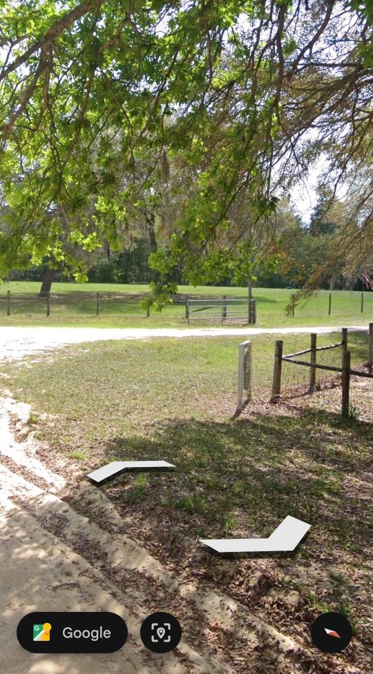

Neighbor horse pasture, so it does grow grass. It's just once the turf mat gets torn up, the soil is very light/loose.View attachment 881873
Maybe you should talk with the neighbor to see what they did to get it started and maintained. I am sure water and fertilizer would be involved.
