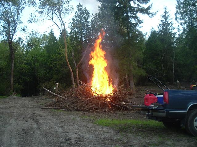

Your loader can stack the debris much higher than a dozer. A trick I learned is to start a good camp fire with firewood beside or even underneath the slash pile. Get this firewood fire going real good with a good bed of coals. I use the log cabin method with 5 or six layers of firewood layed 90 degrees each layer. Once the hot bed it established, push the pile over on top of it. You can add diesel while the fire is burning but I would avoid the gas can as a general rule.
Here is a pic of my last attempt. It was still too wet and the slash was too large. This was a mostly diesel fire. The pile is still there waiting to dry for another attempt. Maybe this weekend.

That red can is a diesel can. FYI
This pile is a baby that I pushed/peeled off of a big pile to start. I am still a little leary of starting a monster pile by myself without a permit. I planned to feed the fire with more debris as needed or to start a separate fire if this one went well.

Your problem is the pile is spread out to far and not high enough. That stuff piled in a small high pile would burn just fine once started. What is the vehicle? parked next to the pile, can't make it out, looks interesting.
My smallest pile for this year is bigger than that, the biggest one would bury my entire truck and car parked end to end and is about 12ft high now. Still growing (sideways, not taller). Gonna be fun next winter.

Aha, that explains the spread out pile. Looks like it would have worked if you had bunched it and added more with the fire going as well as it shows.
Harry K

The pickup in the foreground is the only vehicle. There is a lawn mower in the bed and a generator with a yellow extension cord stowed on it. I think it is photo trickery since there was nothing close to the fire but a fan waiting for duty.
That pile is about 6 feet tall but 12 feet or so wide. The dozer can push stuff but not lift and stack. I agree that the proper height to width ratio should be better for the fire to work well. This pile would have burned well if it was dry but not wet. I would like to see 3 or so of those piles stacked for a good burn.
That fire smoldered for about a week and a half but still looks about the same.
