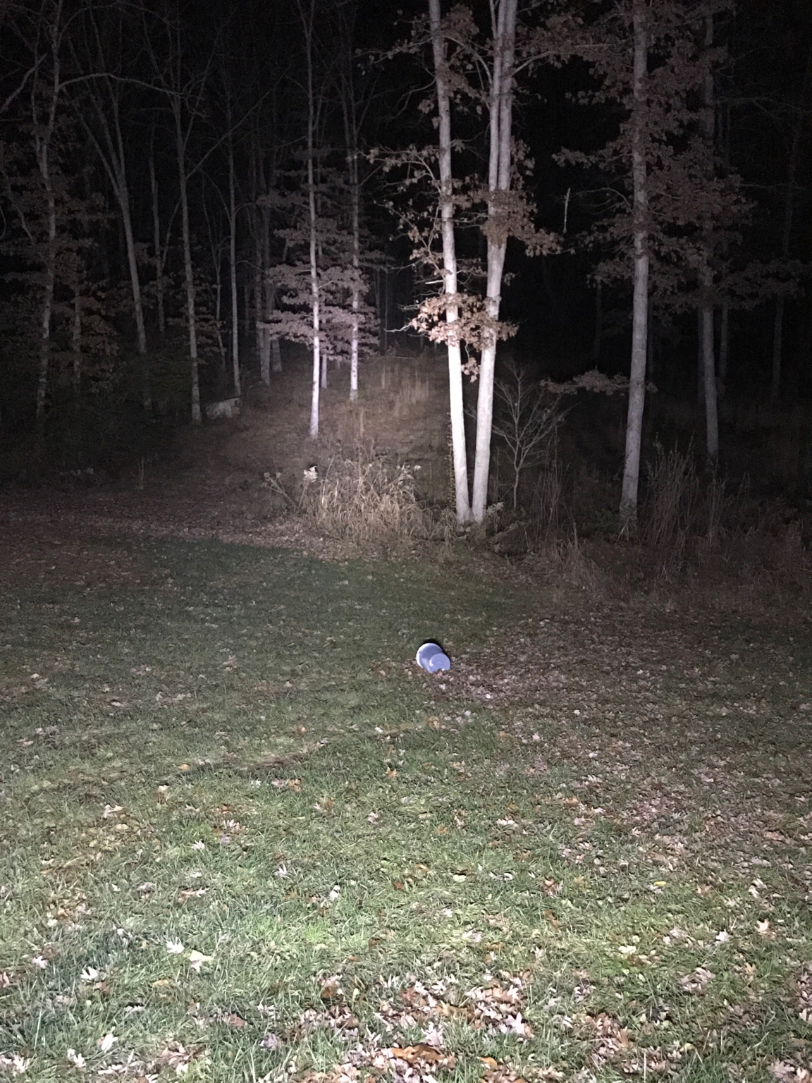

I went way overkill on power distribution & light bar install on my L4060. http://www.tractorbynet.com/forums/customization/376458-let-there-light-l4060-light.html
The cheap ($50-70) LED light bars both pulled around half the advertised wattage. 42-50" bars if I remember suppose to pull 250 & 300 watts, but tested at half that in the automotive voltage ranges. Both hella bright though. I might replace one because it is noisy on the RF spectrum & kills the radio reception.
That's a really nice setup. Something like that is my goal. With the colder weather here, it might have to wait until Spring. My biggest issue at the moment is how to mount the lights (No cab for me) so that when I'm mowing and the tree branches smack the ROPS, my lights don't move / get damaged. On my last tractor, I had fabricated brackets to protect the lights, but then branches would get hung up on it, because it stuck out past the ROPS - not allowing branches to ride up the ROPS and fall off. More thinking I guess.
