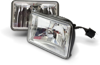

Your Org.# LB-4520 is only a 25/25w. With a dyno your maxed out at 180. I don't know your Elec. Sys. Gauges Etc. so keep that in mind and your have to add that in also. I can turn my dash off and if you are able to do that then wire the Lights in a separate Circuit.
15 amps X 12 volts = 180 watts.
Keep in mind that this is maximum output for this very puny little alternator. Alternators also produce less power when hot, and that 15 amp rating is at a high RPM, which is not stated.

One of the forum sponsors does have LED lights for our tractors ...
http://www.tractorbynet.com/forums/owning-operating/232466-led-xenon-work-lights-your.html
Maybe these are drop in for the YM series. Maybe we just ask for the measurements.
Peterson LED Headlights
The Peterson's are made in the USA. They make headlamps for the older motorcycle and ATV stuff in LED. With that said, the Yanmar headlamps often used the motorcycle square headlamps.
Vehicle Safety Light| LED Lights - Peterson Manufacturing Company 702/703 - 4"x6" Rectangular LED Headlights
