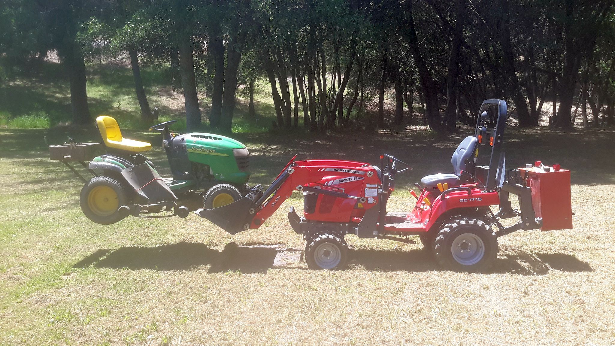

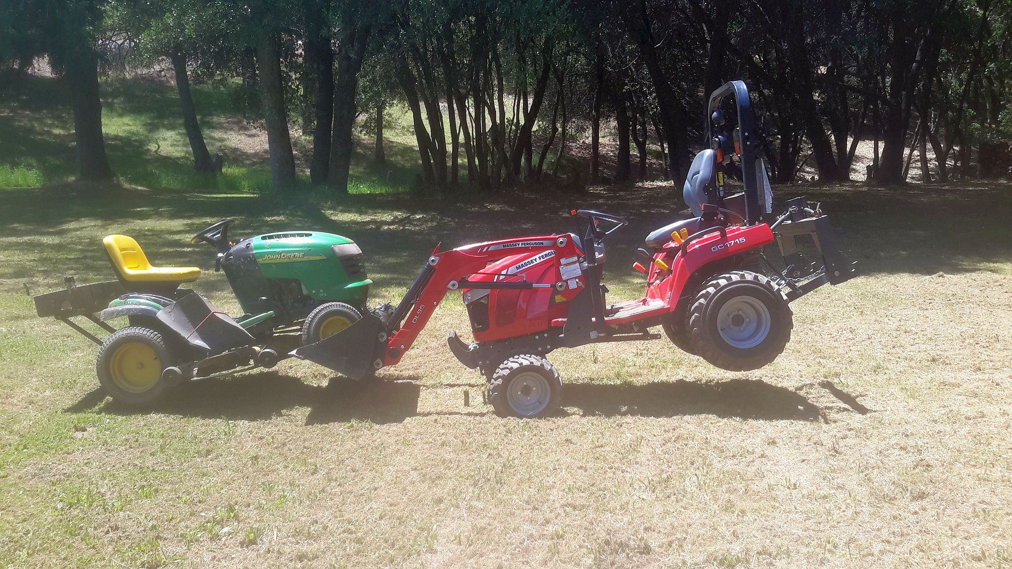

I made a 2x2x1 foot steel box, and it weighs in about 500+ pounds probabl would have gone bigger but it was all the steel materials I has on hand to create with, beside I have small tractor........ Concrete weighs in at about 150 per cubic foot... And box took nine 60lb bags of sackcrete.... So design with weigh per cubic foot in mind....
There are several threads on sit about ballast or counter weight or what ever you choose to call it.... Migh try search feature....
This is what rear weight will do for you...
JD tractor weighs in at 520 pounds by JD manual...

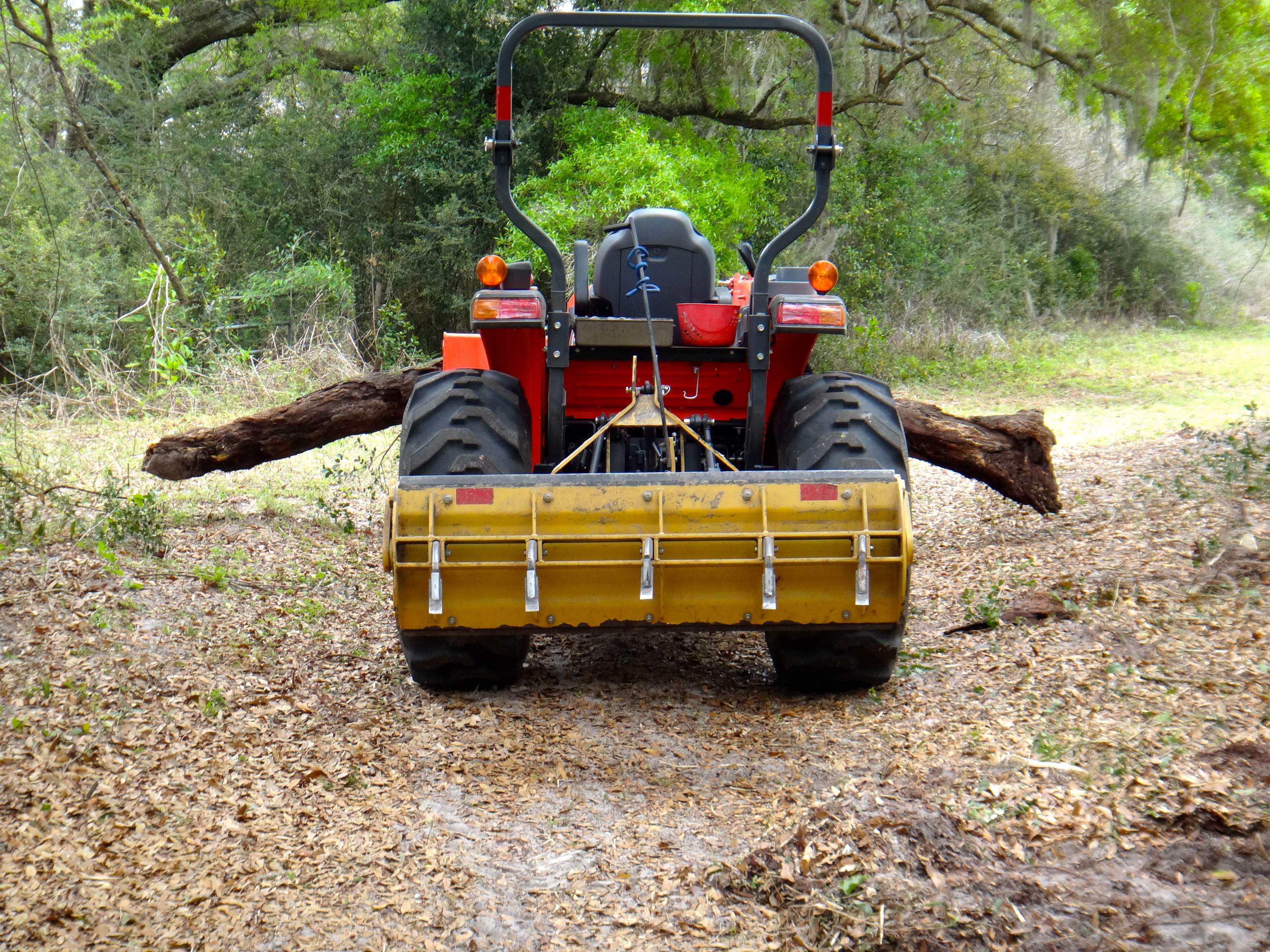

With my TC33D, I would just put my 700lb tiller on the 3pt and it seemed about right. I could go lighter for less demanding loader work.

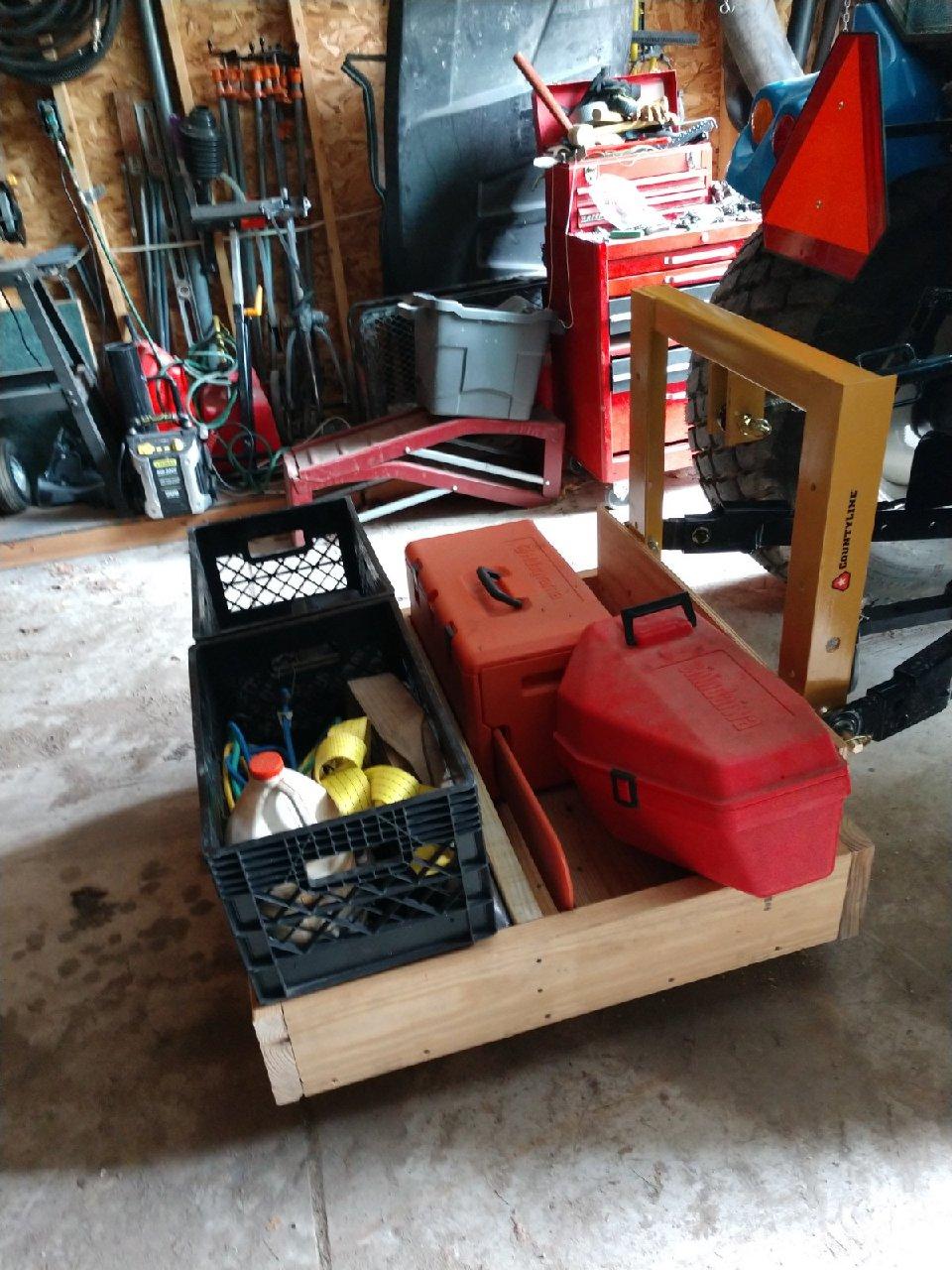

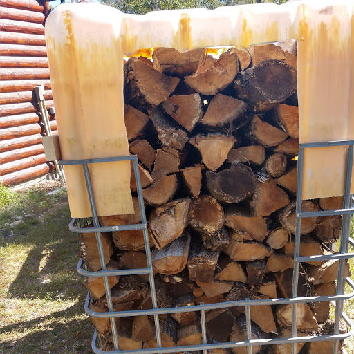

I purchased a carry all from TSC and added about 750 lbs of lead ingots to the rear of it. Lead is easy for me to get and is very dense so I could still make use of the carry all to carry stuff. The milk crates keep the ingots from bouncing out.
I can lift almost half a cord of wood in the modified IBC tote below but have not lifted to full height as I have no need to:

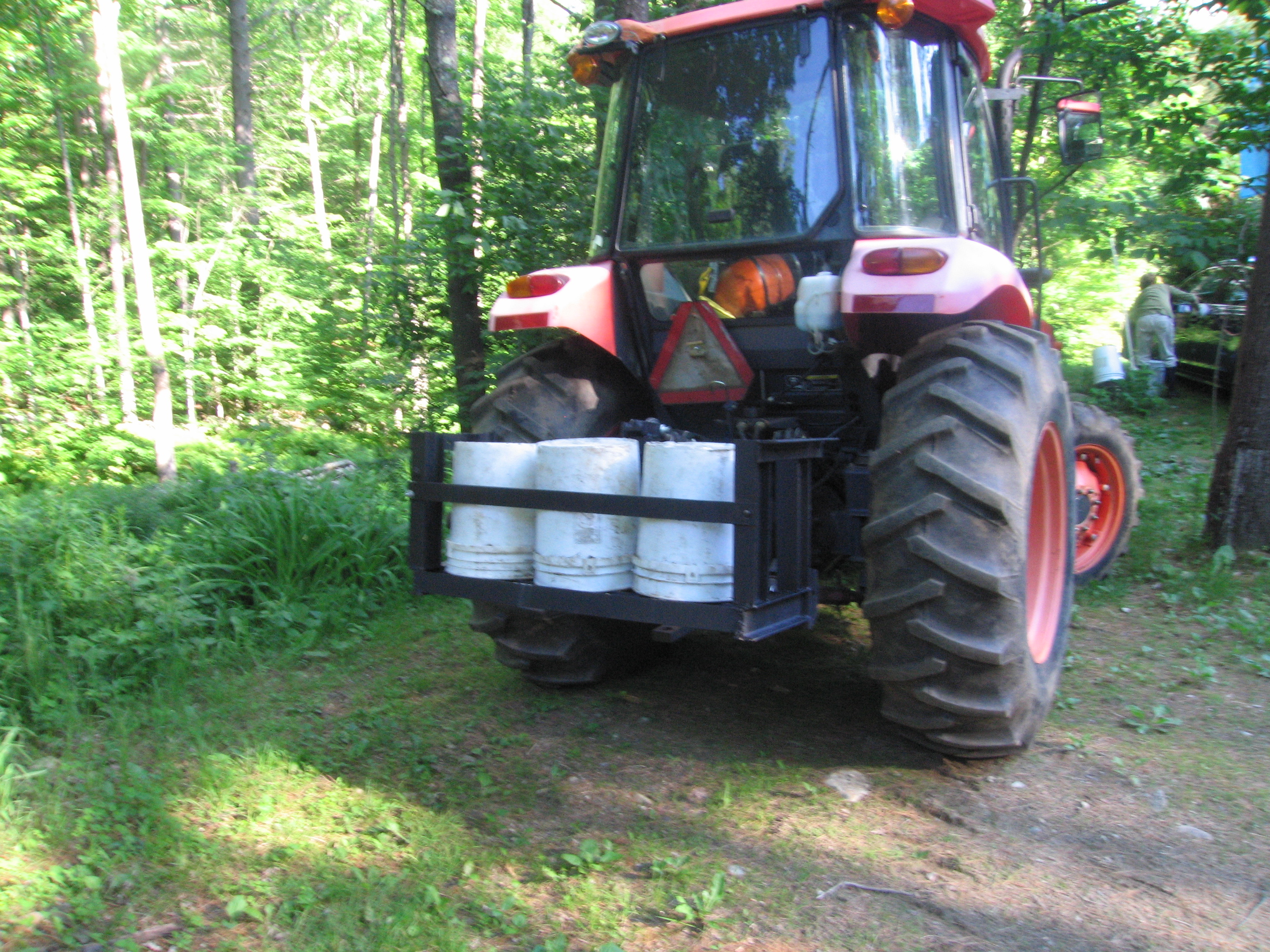

On my M, I used to run with my box blade as ballast and it worked fine but it is large and cumbersome when maneuvering in tight quarters.
I built a ballast box from I beams and some scrap steel I had lying around and put 3 5gallon buckets of concrete in it. Probably weighs 400 + lbs.
That and 75% loaded tires is more than adequate for anything I need to lift And it is a much more compact load.IMG_1385.jpg
