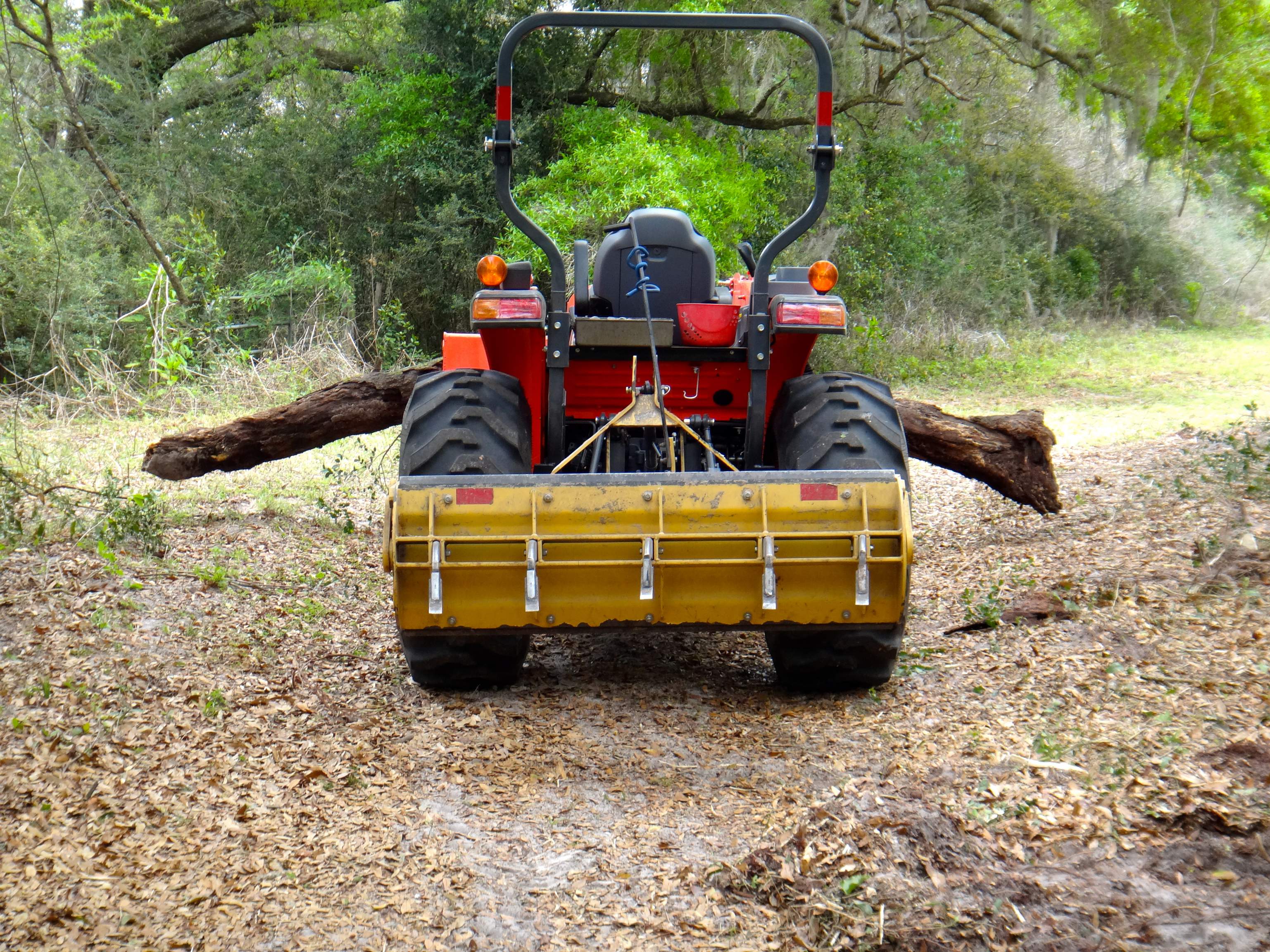

Implements most often used for counterbalance are the Box Blade and Roto-tiller. I often use a Cultipacker. LEVERAGE makes a 700 pound counterbalance implement protruding 48" to the rear of tractor more effective counterbalance than 700 pound implement protruding 30".

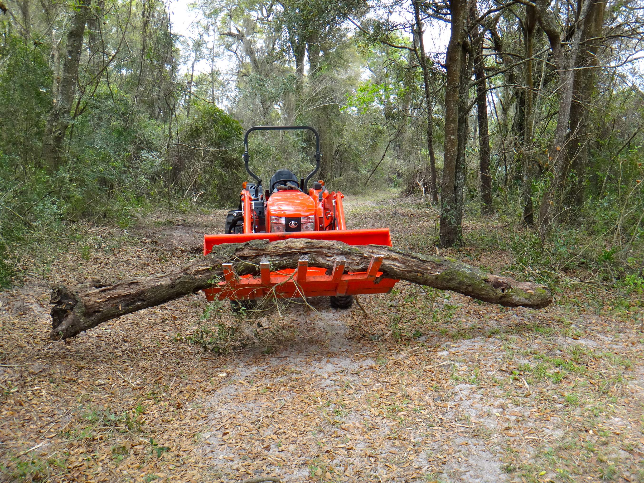

The combination of 500 pounds tire ballast and a 600 pound implement should allow you to safely lift 1,800 - 2,000 pound FEL loads. FEL bucket is bad enough, should you add Pallet Forks which allow you to lift heavier FEL loads, you can enter rollover territory in one heartbeat.
For max loads, which should be infrequent, use your 900 pound Disc Harrow, which extends far to the rear, increasing leverage holding down the rear wheels.

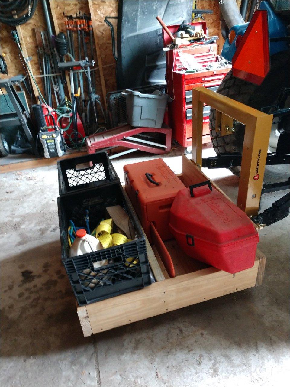

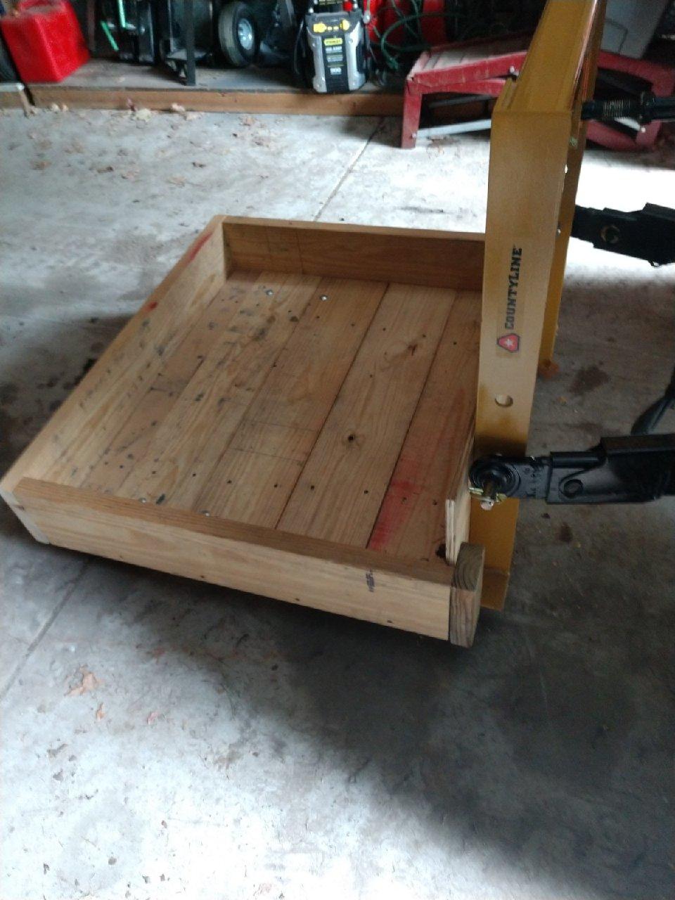

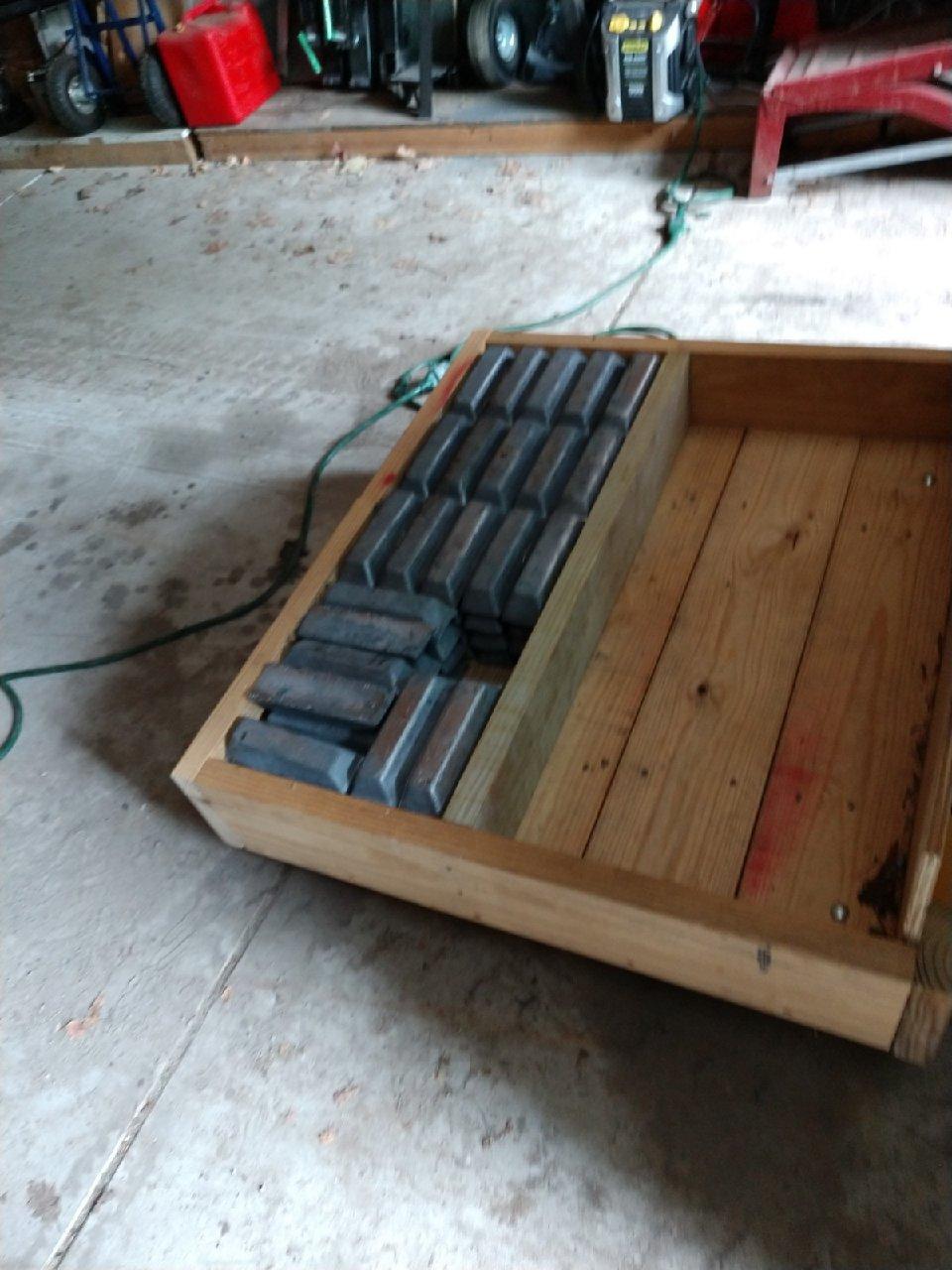

I was thinking of a Carry-All and trying to think of weighs (see what I did there?) to add temporary weight to it and still use it for a carryall when no weigh it needed. I don't have access to lead unfortunately.
I do have a 55 gal steel drum......
You might want to consider having two "boxes" that utilize the carry all.. One to serve as the ballast box and another to serve as a tool/stuff carrier. Build the bottoms like a small pallet for the carry all forks and use pins or bolts to hold the side of the box to the uprights of the carry all. Much easier to swap boxes than adding and removing weights. I made my box that way so I could use my carry all to move pallets until I got a SSQA set of forks. I put the box on HF dollies so I could move it easily when not on the tractor.
