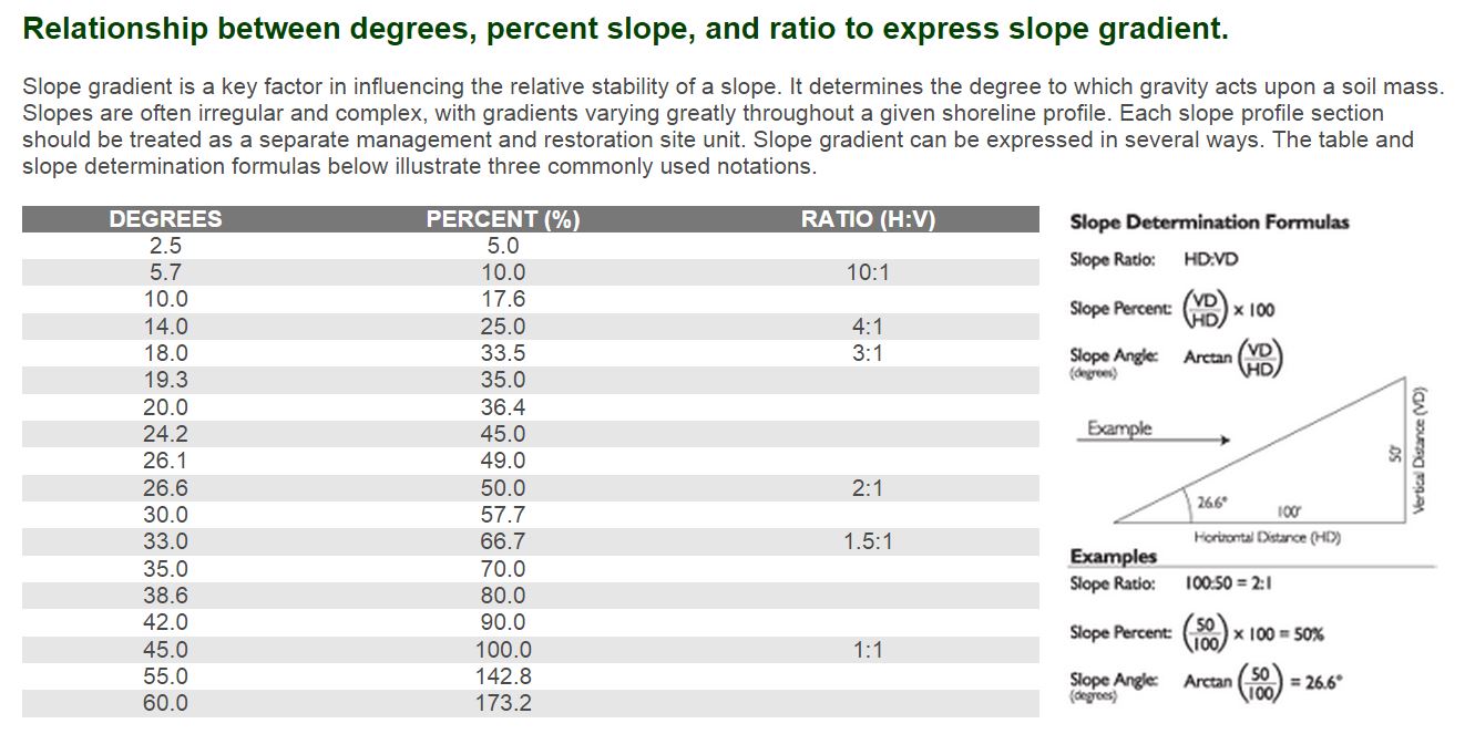

Can a 40hp tractor tow a 9000-10000lb boat/trailer up (and down) a 5-7% grade? Speed not an issue. Just moving a boat trailer to and from a boat ramp on rural dirt road. Mostly flat except for one hill.
How did you determine the grade of the hill?
5-7% isn't much of a hill.

How did you determine the grade of the hill? 5-7% isn't much of a hill. <img src="http://www.tractorbynet.com/forums/attachment.php?attachmentid=470381"/>
5-7% is a guesstimate. I traverse the road (side to side) frequently and notice a slope but my sphincter does not contract. I have calibrated my sphincter using a bubble gauge while traversing various slopes and know that initial warnings start about 9-10 degrees and that panic sets in at about 15. The hill in question doesn't set off alarms so I'm guessing 5-7%. It does vary a bit over the 900 feet from top to bottom.
