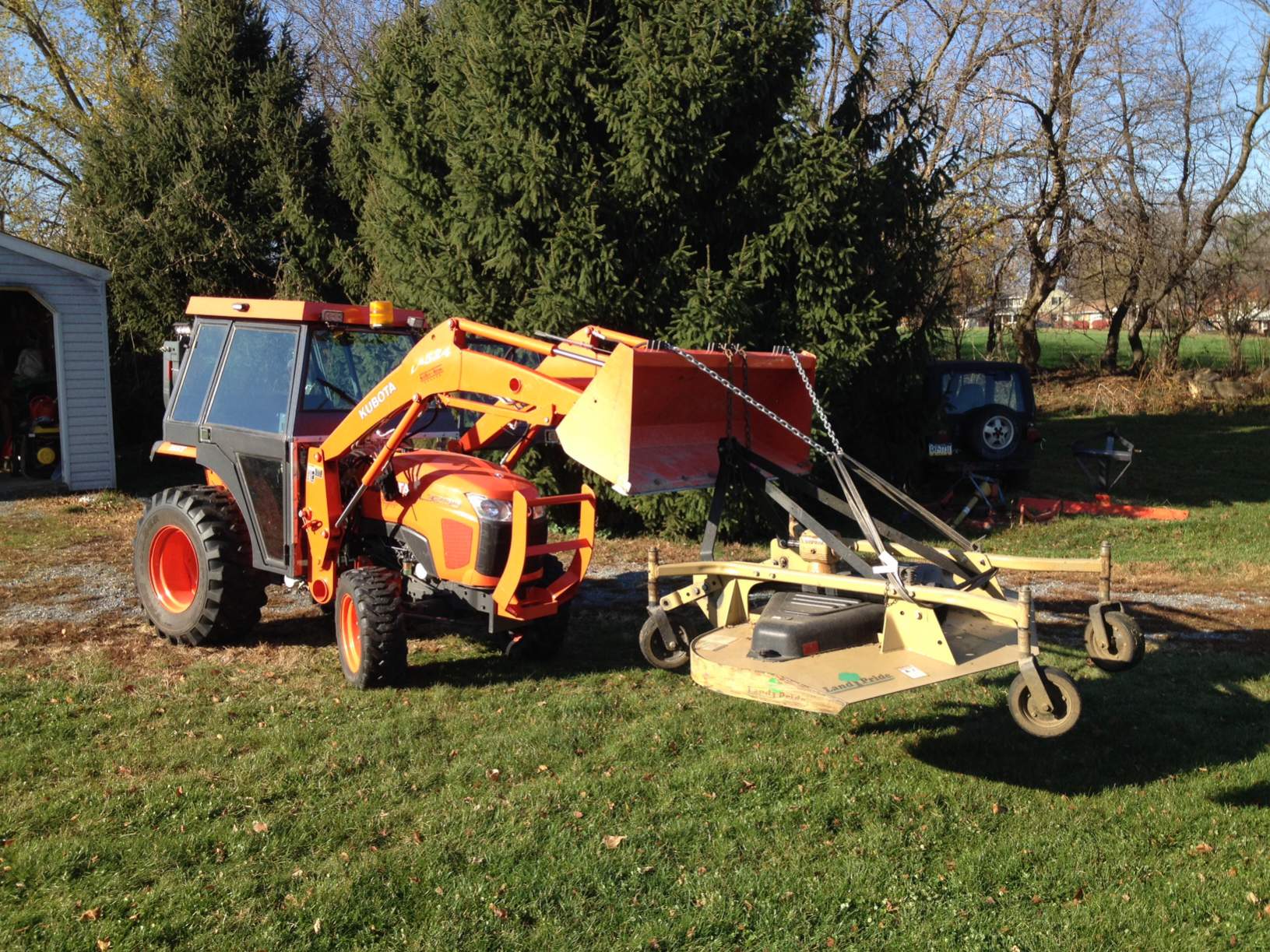

My approach wasn't nearly so scientific. I had a B7500 that wouldn't lift everything I wanted it to lift. It was replaced with an L3200 that does lift everything I want to lift, plus some.

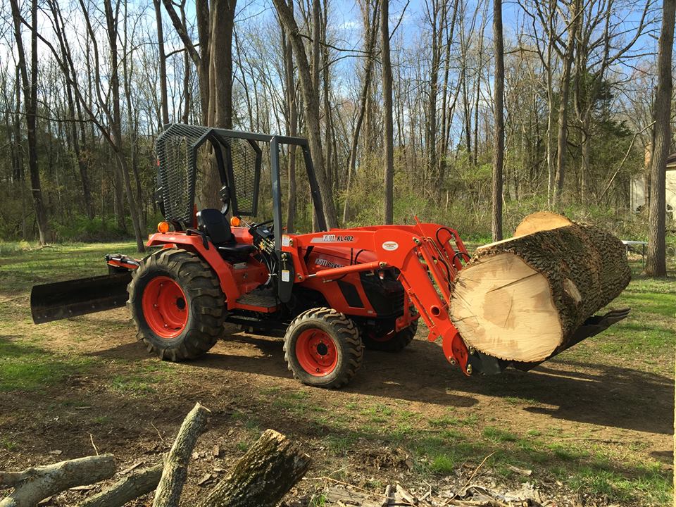

I don't know how much my tractor can actually lift. I don't have enough objects of known weight around to measure it. The heaviest thing I ever lifted was a 9 foot long 3.5 foot diameter log (Ash). It's hard to say what this log weighed. I didn't dare lift it more than a few inches off the ground because even with a 200 pound cage, 1000 pounds of tire fill and a 500 pound blade on the back, the back end was hovering. With this same ballast, I can lift the back end completely off the ground if I'm digging up a stump with the bucket.
