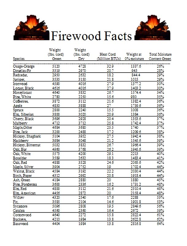

This chart looks reasonable and has moisture content for green Ash at 45%. I cut this particular tree down at my Aunt's house just days before because it was dying - only had a hand full of leaves this year. So it was likely dryer than the 45% for a healthy green tree.
Thats one of the charts saved in my references. Have about a dozen different ones regarding wood weights, moistures, cord weights, etc. Got tired of searching all the time:laughing:
