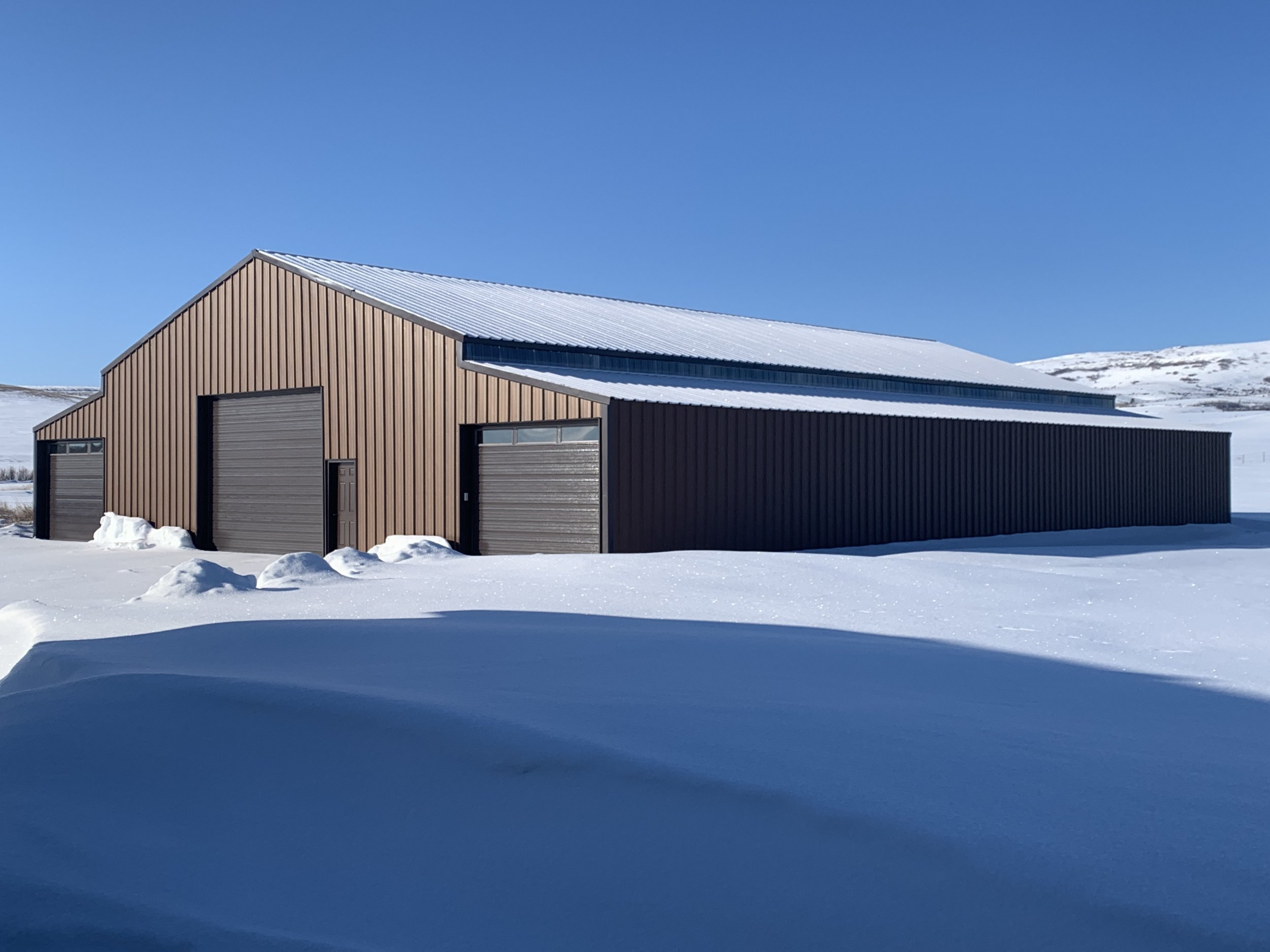

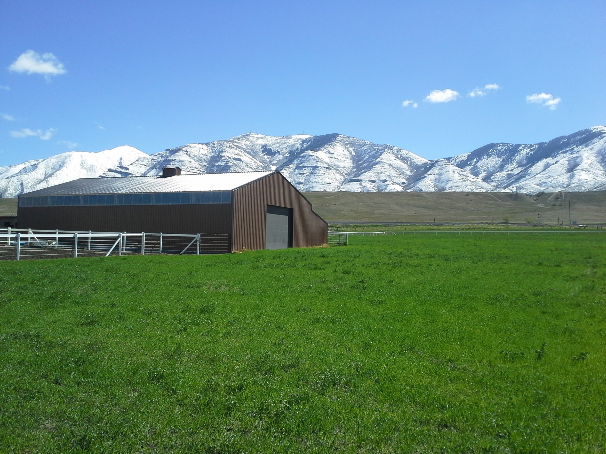

I have built 4 pole buildings over the years. The plans are in my head. Do you have the skill to build it yourself or are you hiring it out? Doing it yourself will save you a lot of money.
As to your question; A pole barn is the least expensive way to go. I think long term metal roof/siding is best although wood gives the look of a "real" barn. And building it yourself gives a certain sense of accomplishment you cannot get from hiring it out. Cost depends on where you live and material availability. I used mostly rough cut lumber right from the sawmill. Posts also right from the sawmill.
Here are the last two I built.
Good luck and make sure to post pictures of your build.

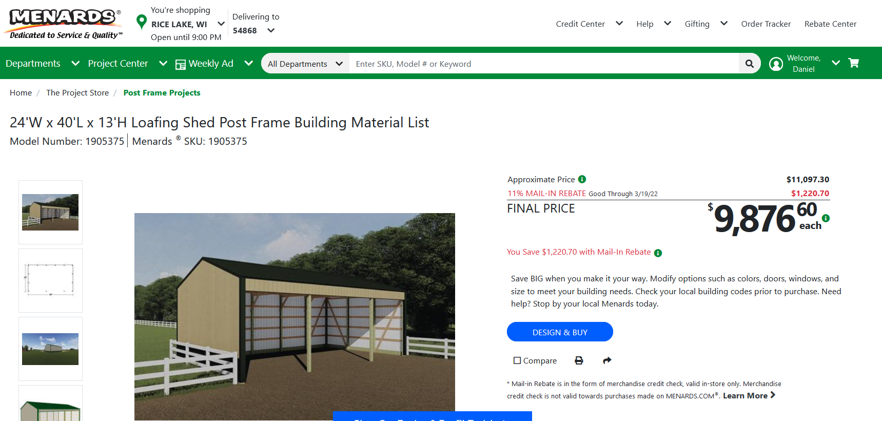

Here is current materials only from Menards for a 24x40 with 3 enclosed sides
