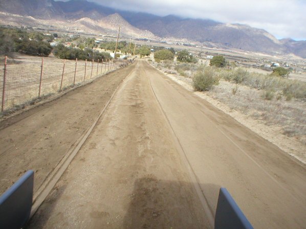

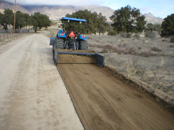

All the links that you have will work for you. What I can tell you first hand is that the heaver the better. You will eliminate your wash boards. The grader blades work great and are the best implement for the job in my opinion, and I have used a rear blade, a box blade, a landscape rake and a Road Master road grader. What you should look for besides the weight is long sides. This helps a lot while grading your road. All these implements will work for grading your road, but the twin blade grader blades seems to work the best for me. I then will do some dress up with the landscape rake if needed.
Oh, I maintain over two miles of road on a regular basis.
