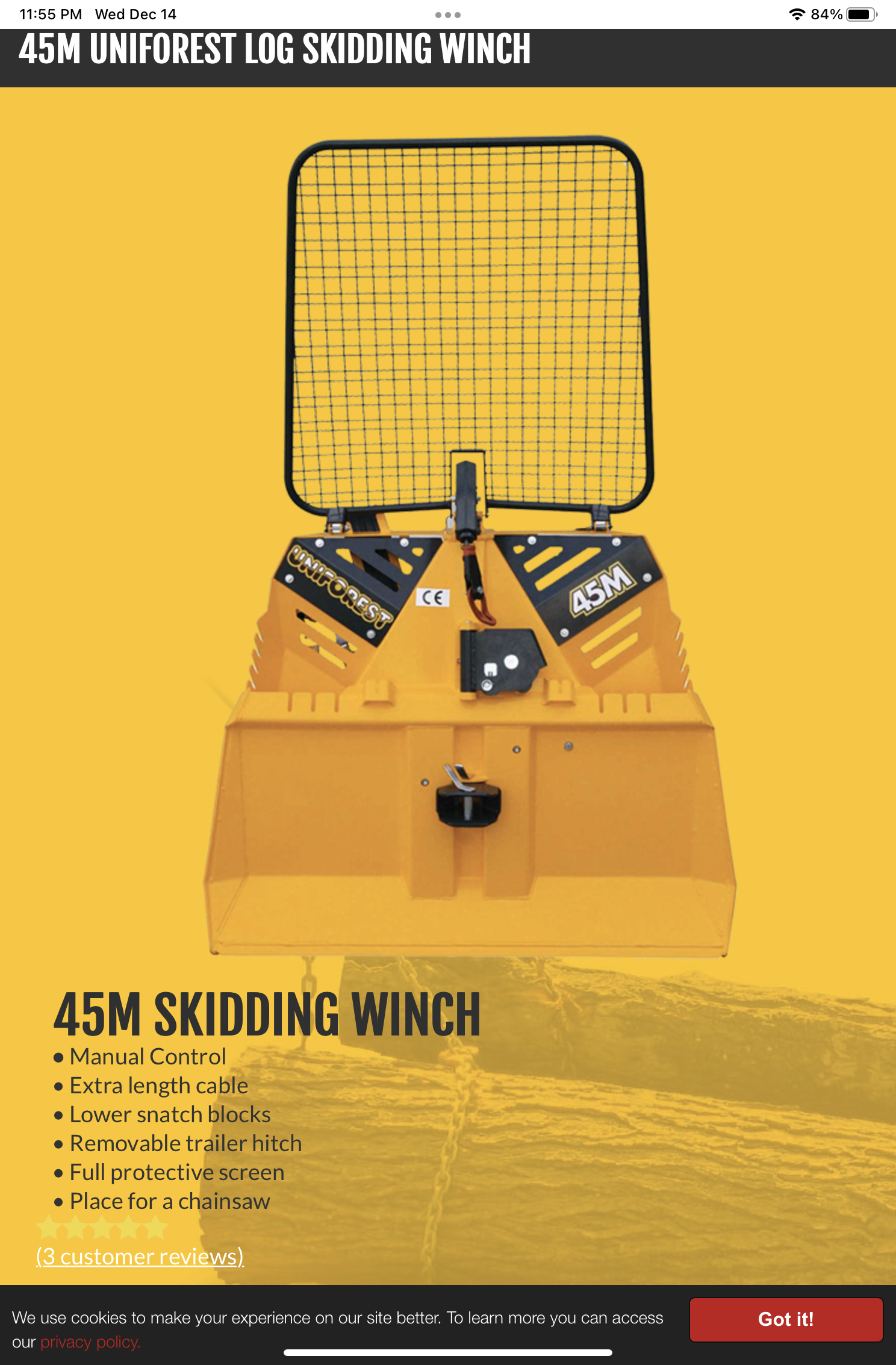

The trees are all eucalypts, about 20" max diameter and 60 to 80 foot tall. I'll be cutting them into pieces perhaps 10-15 feet long and pulling them out into a cleared area for further cutting. Using chains.
You might consider a three point forestry winch. With chains you need to have a space for the tractor to run to make the pull, and it has to be in line with the direction you want to pull. With a winch you park the tractor and pull the log towards it. With a snatch block you can redirect the pull using a handy tree, and with a self-releasing snatch block you can do it without having to stop and detatch the cable from the block.
Once you get the logs to the winch you can use the winch to drag them off. Or what I do is to cut them to 8' and carry them with a grapple on the front of the tractor. That way they don't damage my roads. There are a lot of videos on youtube showing how they work.

For dragging logs and saving roll overs on you tractor.
