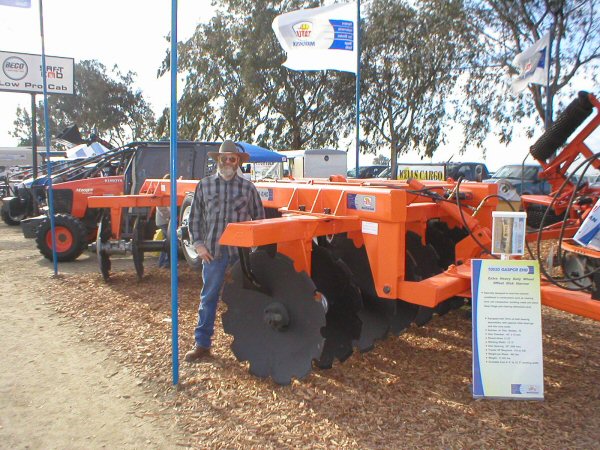

Heaviest disc harrow I'd ever seen was a Rome disk plow. They come in lot's of different configurations but that's what's commonly found on highway road jobs. The lighter ones they pull with 530hp 9000 series and the ones with some "heft" they hitch 'em to the D-10's.
AKfish
   / How much HP for a 12' disk? #37
AKfish
Come on now, I can pull one of those with my 16hp Sears garden tractor. :rolleyes: :laughing: ;)
This is one of my favorite units. :cool:
