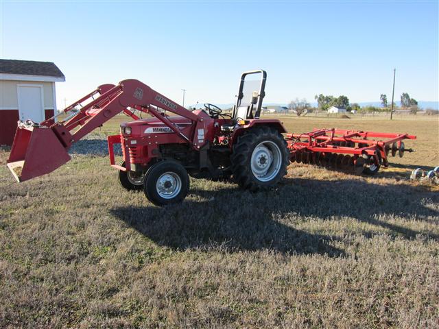

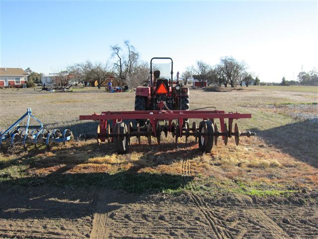

My wheel disc is a Minneapolis Moline KA-1300 tandem design (4 axles, 12 pans (20" size) per axle, 13-ft wide). Made by Krause. Bought it from my tractor guy ($600 including delivery).
I can pull it with my 2008 Mahindra 5525 (55 hp engine, don't know the drawbar hp) in dry soil. But it bogs down fast in damp soil.
So I cut it down to about 8 ft wide (7 pans per axle) so the 5525 can handle it in softer soil.
Your tractors ought to be able to handle your 12-ft disc OK.
Good luck.
<img src="http://www.tractorbynet.com/forums/attachment.php?attachmentid=309141"/><img src="http://www.tractorbynet.com/forums/attachment.php?attachmentid=309142"/>
Good luck.
If I could find a disc in as good of shape as yours for $600, I would buy it without question. We will have atleast that much in one of the ones we looked at after putting alot of work into it. There just isn't lot of good used equipment around here, at least not that is advertised. It seems that I have to go west of Cincinnati, or north of Columbus to find any kind of a deal on anything. I've been looking for a good 5' tiller(to run on my MF150) and a big heavy box blade for my Zetor for over a year and nothing has come up that was worth the asking price. I have finally decided to just buy a new king kutter tiller, and will continue the box blade search.

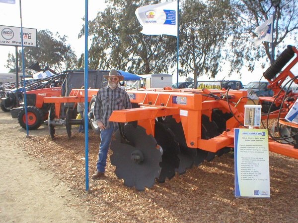

This is one of my favorite units. :cool:
   / How much HP for a 12' disk? #38
Bigger Disk's?
Check out one of these. :thumbsup:
Canadian eh!
