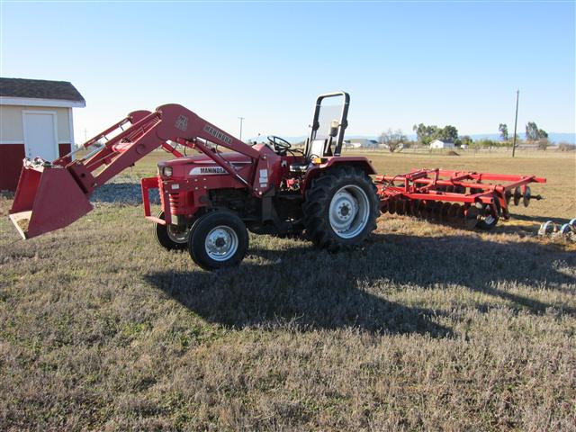

My wheel disc is a Minneapolis Moline KA-1300 tandem design (4 axles, 12 pans (20" size) per axle, 13-ft wide). Made by Krause. Bought it from my tractor guy ($600 including delivery).
I can pull it with my 2008 Mahindra 5525 (55 hp engine, don't know the drawbar hp) in dry soil. But it bogs down fast in damp soil.
So I cut it down to about 8 ft wide (7 pans per axle) so the 5525 can handle it in softer soil.

Your tractors ought to be able to handle your 12-ft disc OK.
Good luck.
Good luck.
