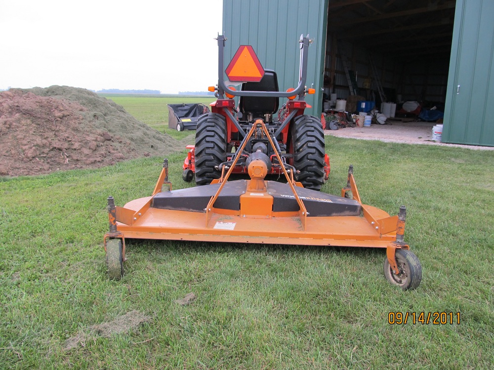

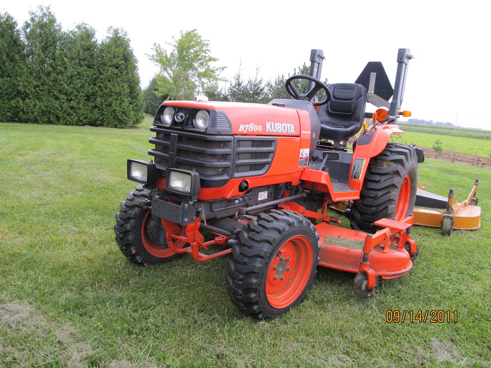

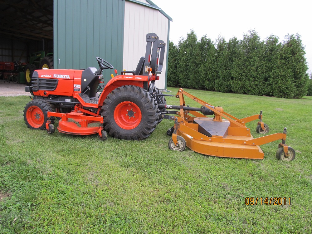

I used to mow at a 3" height with my B7800 and 6 ft side discharge mower and there was always clumping and annoying piles of grass. This year I switched back to my Woods 7 ft RD8400 three blade rear discharge mower and went to 3 1/2" high. There is zero grass to rake and mower is faster and a whole lot more pleasant. No more side discharge for me.

Looks like you have a nice setup thanks for the pics! :)
