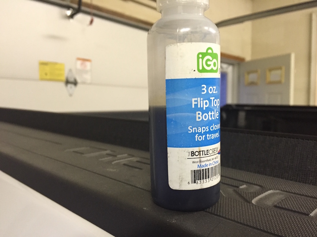

Picked up on a 2006 Cadillac CTS 3.6 with 52,000 miles a few weeks ago and in immaculate condition. Lots of folks claim these motors "use" a lot of oil, and they do. Read all kinds of 1 qt in 1000-1500 mile stories and that it is "normal". But I cleaned the MAF and Throttle Body, did a CRC Intake Valve Cleaner job on the top side, did an engine oil flush and changed oil and filter. The kicker was, I put on a Elite Engineering PCV oil catch can on the engine. I think I found where the oil is going that they are "using". This is the result of just one week / 240 miles, almost 2 oz. Getting sucked thru the PCV tube is not my idea of "using" oil by the engine. The level of what the Elite can captures virtually mirrors what the engine is "using". So essentially, the engine is actually nice and tight and not using any oil at all. But it is "consuming" it.
That's the issue with both of mine, the crank case is vented back into the intake and because the crankcase is pressurized by the turbo, it'll push some oil through that vent. I removed that intake vent on the 7.3 (which also uses oil to drive the injectors) and vented it to atmosphere like International does with the big brother trucks using the same engine, it still consumes some oil but I don't have the carbon and gunk buildup in the intake and turbo anymore.
Same thing with the BMW but I have not put a catch can in, higher boost pressures push more oil through the PCV, it ends up going through the intake into the turbo.
You're right though, my choice of words was poor, I should have said they consume oil, not use it. It's not an engine problem with either or mine (or yours), it's just a design issue on the CCV.

In my case, my turbo diesel 7.3 also uses oil to run the injectors and has a crankcase vent that will bypass oil. The offender in the BMW is the CCV as well, and the higher my boost pressures, the more oil I lose. Neither is actually burning the oil.

It was not intended as a poke at your choice of words so much as it was getting to the heart of what is actually going on. I did similar to a 2006 Jeep Liberty Diesel. They had the CCV tube routed to just before the turbo and oil would get sucked up by the vacuum on that side when the turbo spooled up. I routed it to the ground just like my 2006 Cummins ISX was from the factory.
At least with the HD commercial engines now that they have gone to CCV since 2007, they are putting oil capture/filtration systems, or "catch cans", on their engines right from the factory. They saw this coming a long way off in testing and realized that they had to remove oil from the CCV to ensure proper operations and long term reliability. The auto / pickup OEM's, they always seem to be the ones who are dragging up the rear and it takes forever for them to get it right.
