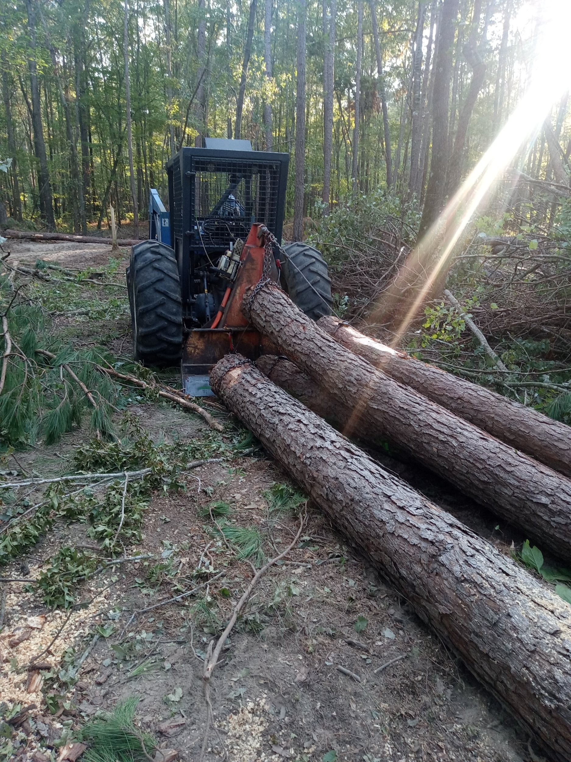

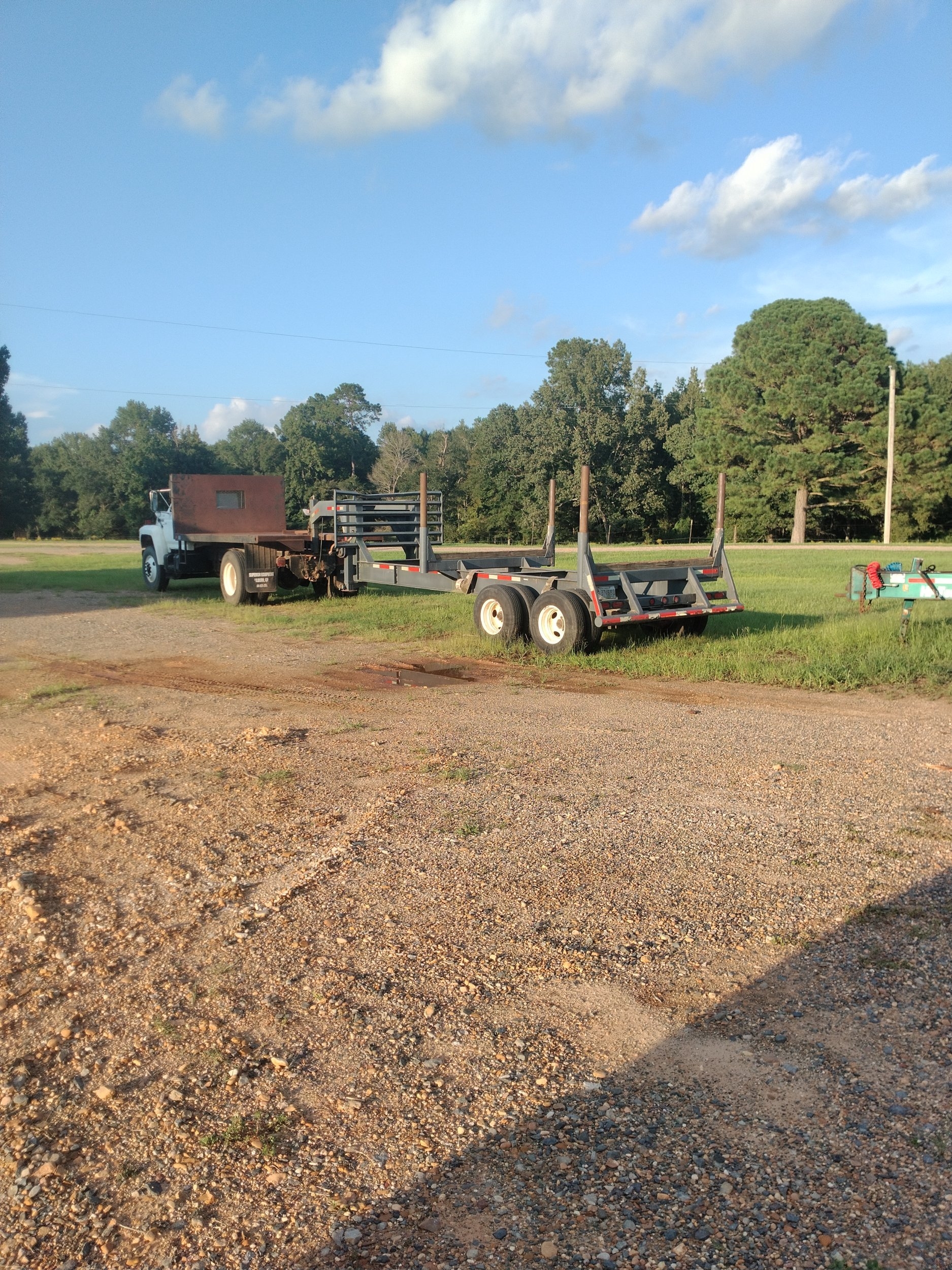

Lots of times we load the trailer and haul it out of woods with tractor.
I like your log trailer GN set up. Very cool. (y)
