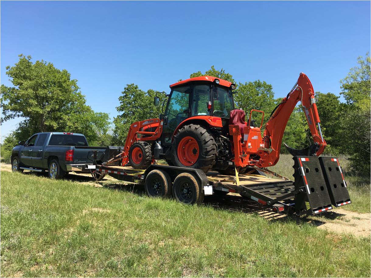

My current and last trailer were tilt beds. Non tilt are much cheaper. I went with tilt beds because of a shoulder injury and could no longer lift ramps by hand. Since I bought my first tilt bed I'll never go back to a non tilt even without any injuries. So much easier and faster to load vehicles. I bought my PJ down toward you in Cortland. The dealer is just off 81 on Rte 11. I'll send you a PM.

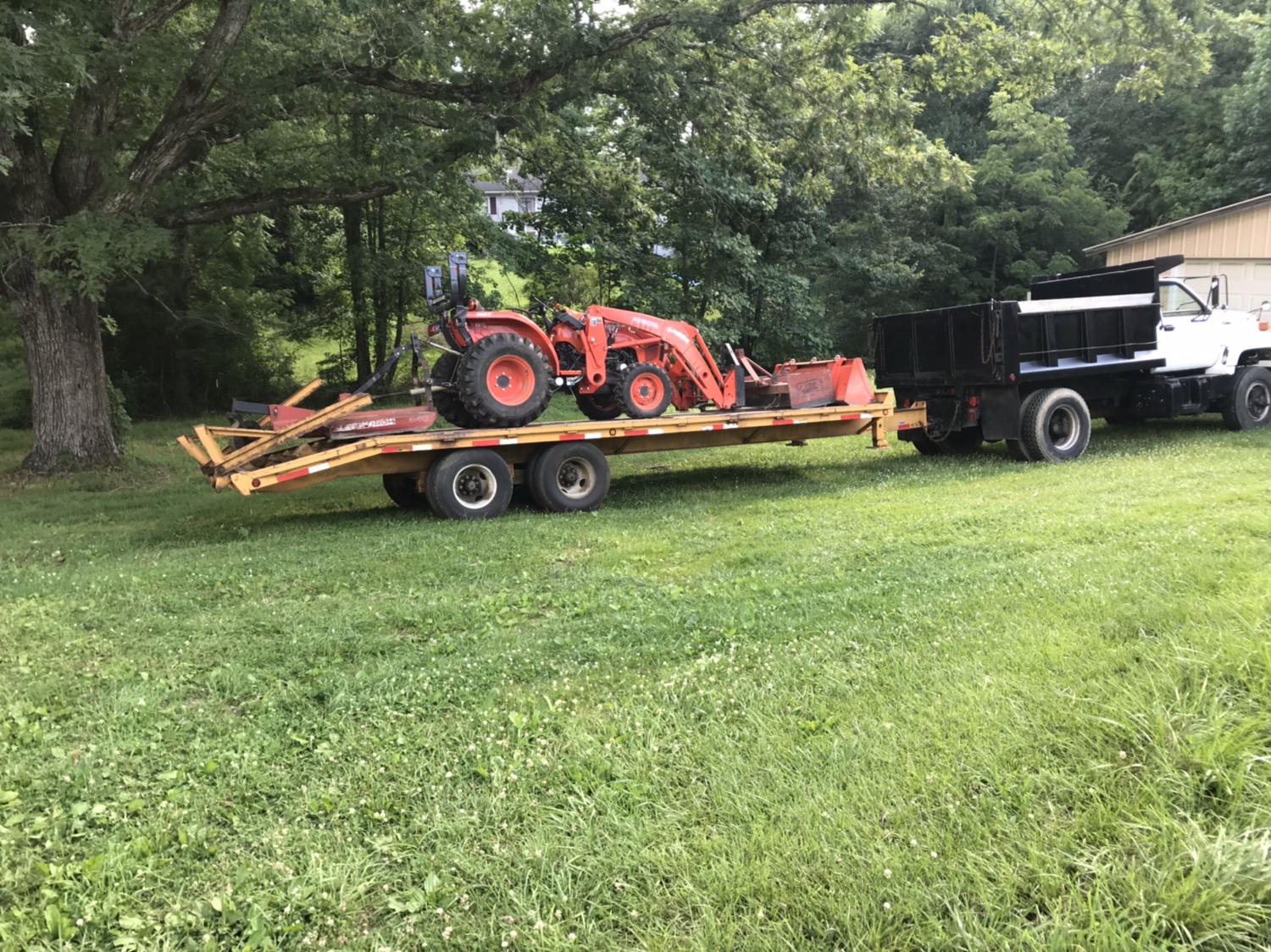

Yes it can be done...
When I hauled my tractor in the dump trailer there was no room for my 6' brush cutter. I put two 2x6 boards across the pickup box and set the brush cutter on those. Cut blocks to fit against the truck bed on the under side and against the brush cutter top side. Strapped it in place with 3 10K ratchet straps. Worked great.

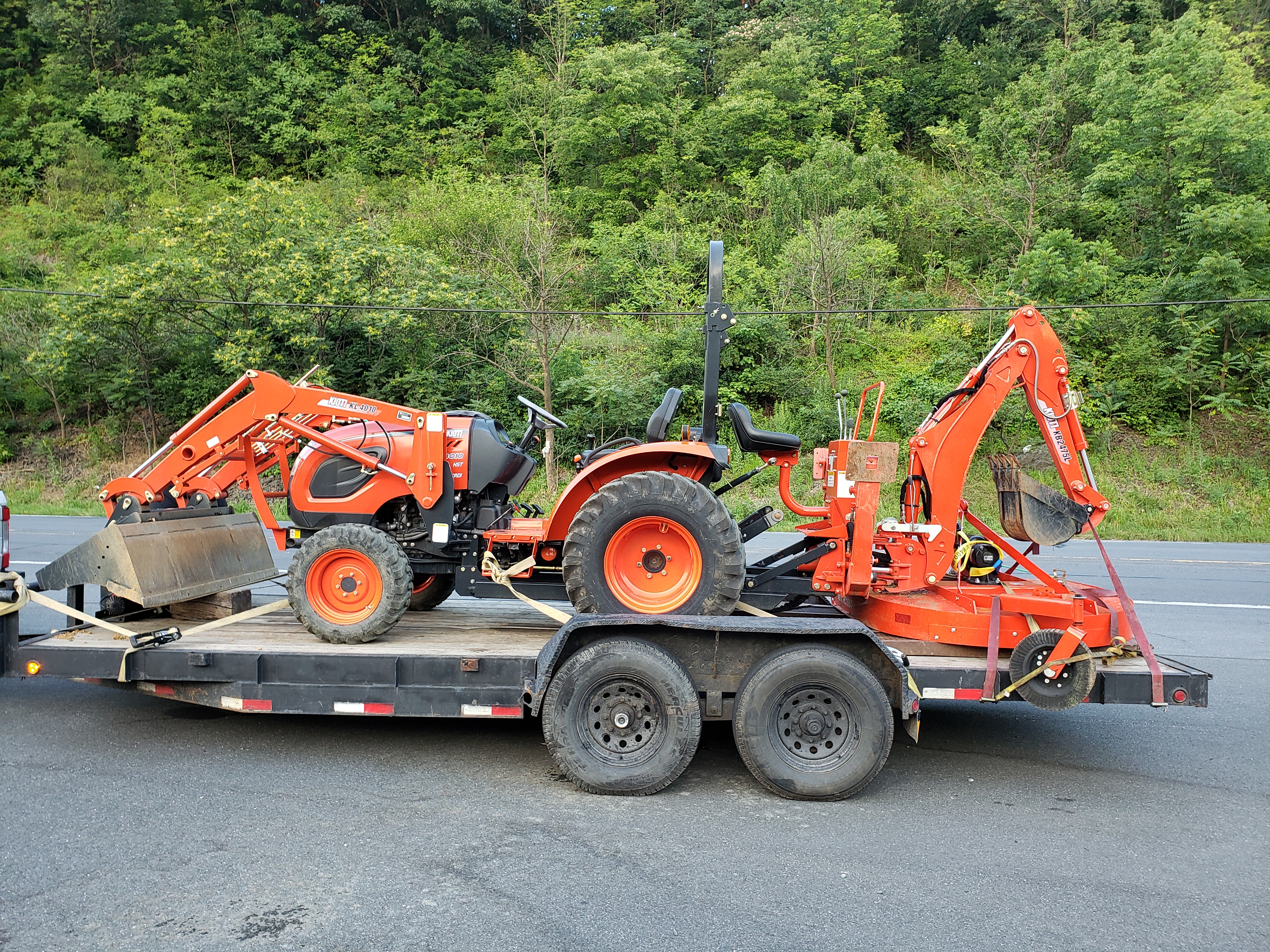

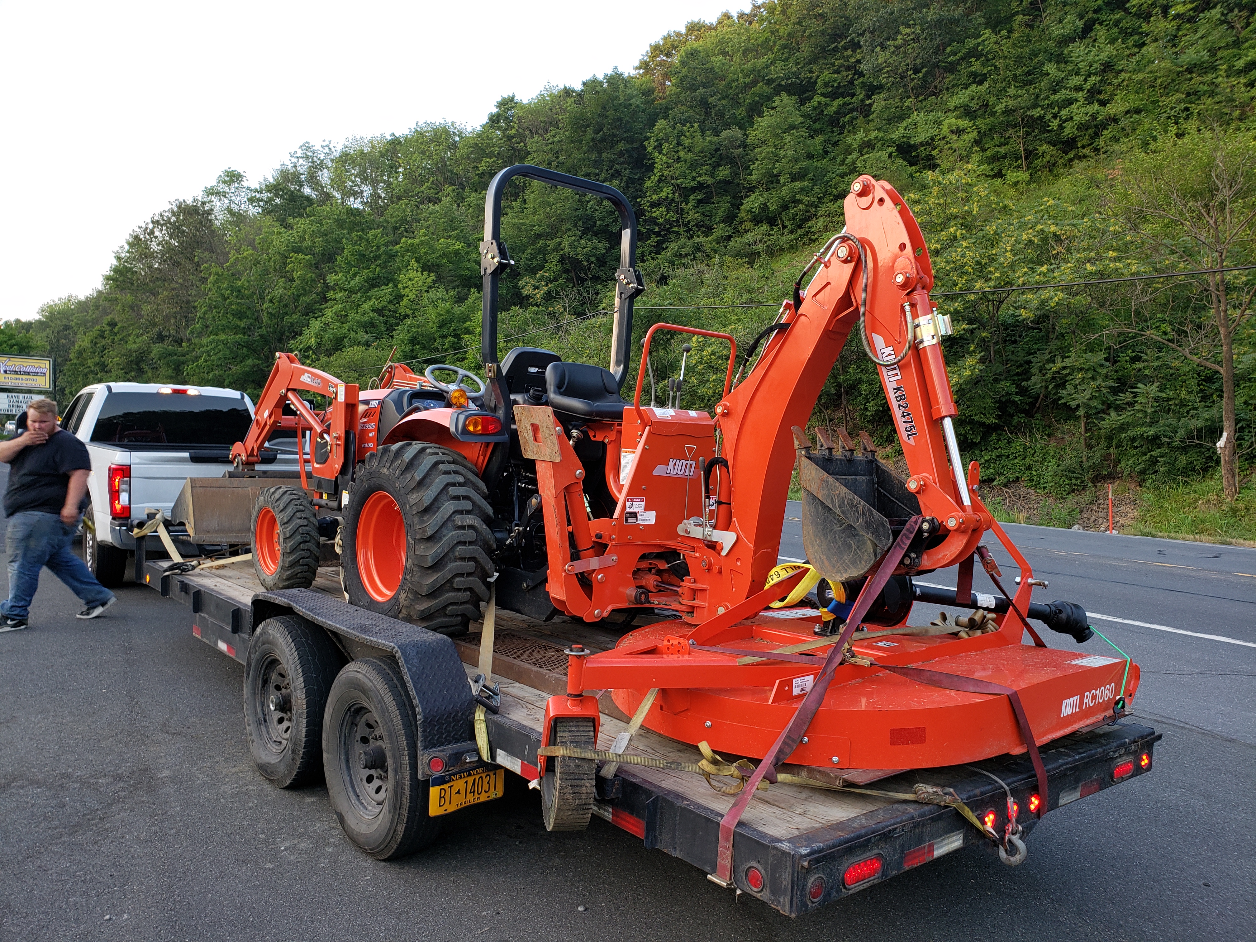

Just so you can see what a CK4010, loader, backhoe and 6' cutter looks like loaded on a 20' (and I mean exactly 20' long) trailer. Towed like nothing was back there. Helps when you have 1200 ft lbs of torque.

How are you loading & unloading that brush hog ??
Probably with the backhoe arm and that yellow sling around the gear box but I think you’d need a helper to keep it from swinging.
I would assume that also.
Me and my buddy Big Chris just lifted it up and set it up there.
Lifting strap and backhoe. Easy peasy. lol
