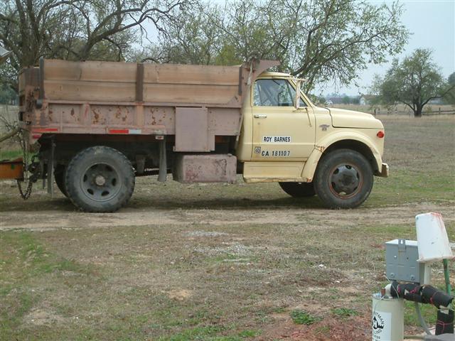

This is the rig my local backhoe contractor uses
DSCF0013 (Small).JPGDSCF0014 (Small).JPGDSCF0015 (Small).JPGDSCF0016 (Small).JPG
Seems to work OK for him.
Good luck

Then there is the friendly guys of DOT. When they check over your truck, trailer, and load, your day will go south. EVERYTHING must me in good working order, and the load properly secured. The trailer pictured above is too short for hauling the JD. When hauling, both buckets must be sitting on the deck.
