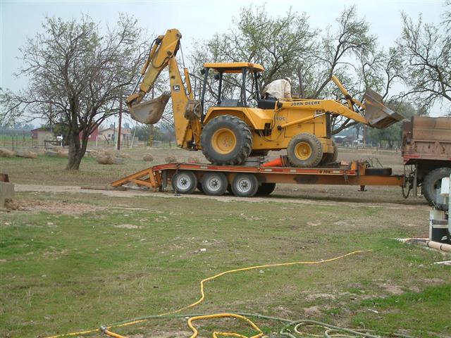

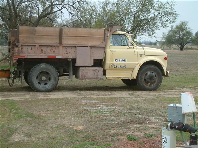

Local guy uses an old F-450 like yours to tow his stuff around using a pintle float hooked to a frame plate type hitch. Works fine for him. They are rated for something like 26,000 lb combined weight and the truck weighs about 6000-7000 lb.
Another local guy has an older F-450 with a roll off deck and he hauls up to about 8 ton on the deck but he did shear the pinion off trying to get moving in soft ground once.
   / How much vehicle to tow Deere 410C Backhoe #12
Old trucks like that don't always have GCVWR's, some had recommended max tow ratings and axle weight ratings. Here, as long as you obey your axle weight ratings for truck and trailer, and have the appropriate registration weights paid up, they could care less if you are doing 10 mph up grades or cut driveshafts off when you try to accelerate fast.
You need to look at the Gross Combined Weight Rating of your trucks. The GCWR is the total weight of truck, trailer and load. It is the legal max. Get into an accident when you're over that max and the lawyers will take you to the cleaners as you're overloaded. Go very far over and then you're into gross negligence with matching penalties $$$$$.
Then look at the weight of a trailer that carry the 410C. Add it all up with a bit extra for tools, attachments and "stuff". That will determine how much truck you'll need.

Bottom line is this: anything you buy that can legally carry your backhoe WILL require a CDL license to drive and that equipment WILL require an annual DOT safety inspection. New, old, pintle, gooseneck or 5th wheel it doesn't matter.
If you buy a 30 year old Mack (or whatever), you had better be prepared to wrench on it to keep it in compliance.
