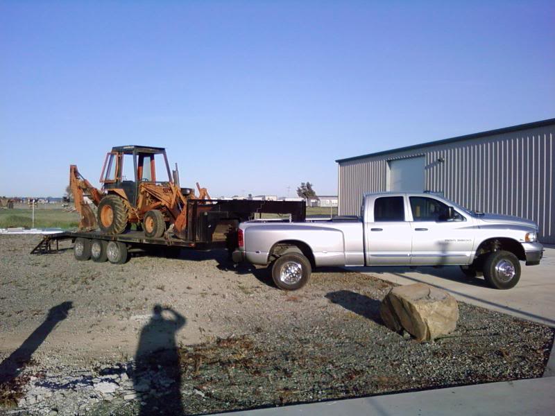

The only place I see 1-ton trucks pulling full-sized TLB's is in television ads. It may be within the weight ratings of some trucks, but that doesn't make it a good idea. Pulling and stopping are two different things.
Try going to a real construction site some time, they pull AND stop the loads just fine... :rolleyes:
Real contractors around here have ten wheelers and triaxles.
I work at a dealership that sells and services full sized TLB's and I can't think of one single customer that hauls a TLB with less than an old F600 or C-70 with a dump body. If someone hauled a TLB in or out in the last 14 years behind a one ton, it was on a day when I wasn't around.
Come to my neck of the woods. You will see it every single day.
Just last week I was in Austin TX and I saw a 2 guys leaving my hotel parking lot.
Truck 1 was a newer Dodge 3500 with a slide in camper, pulling a 35' camper, pulling a 23' Boston Whaler.
Truck 2 was a 08 or newer F-350 with a Polaris UTV in the bed, pulling a 35' camper, pulling a 20' car hauler with another UTV and 2 quads.
The guy across the street pulls his Case 560 BH to every job site with his SRW Ford F-350 and tri axle equipment trailer.
I agree. We pull big loads like that all the time here.
