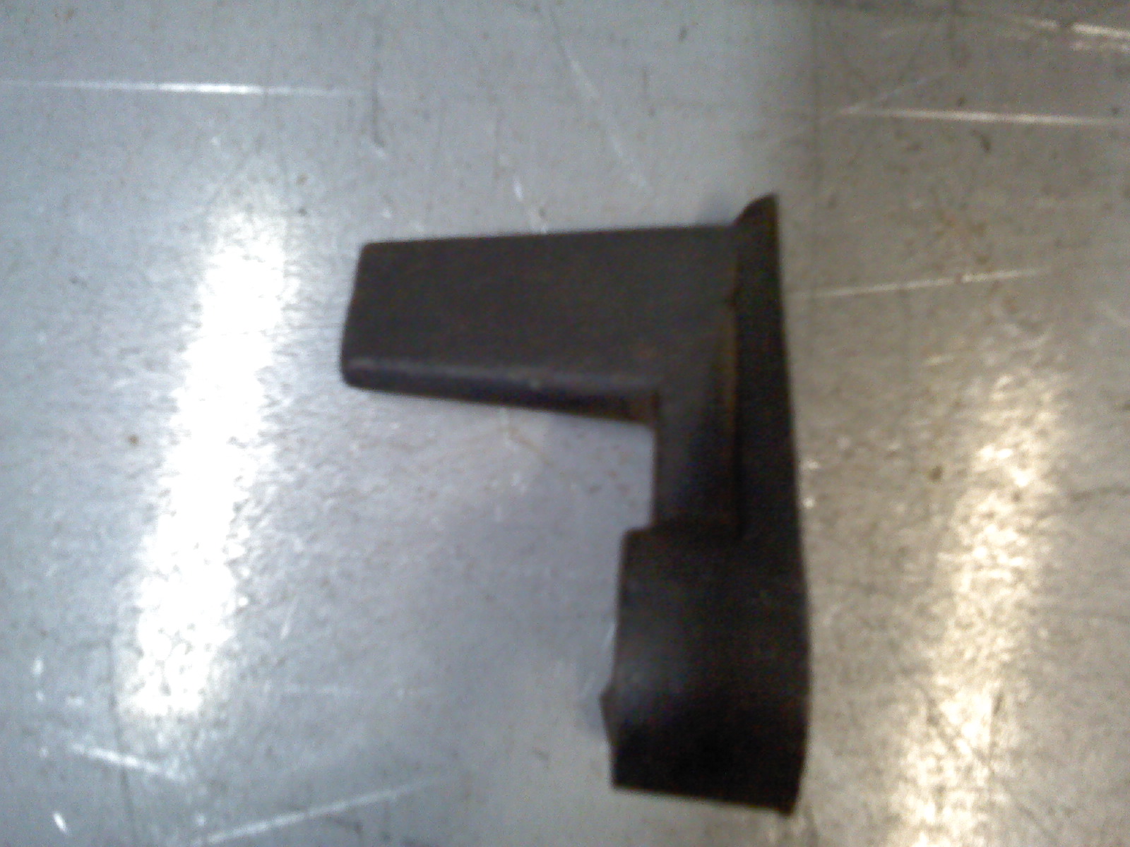

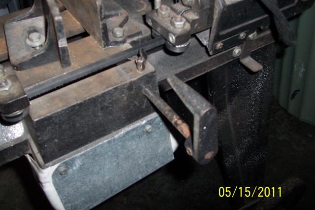

I see in the picture of yours it has a hole to the right side of the table. Get yourself a 1/2" dia. rod about 24" long and make a stop so you can make repeated cuts without having to measure everyone. I have a stand I bought at the scrap yard I go to all the time and it is adjustable but no roller. I realy dont think you need a roller but thats up to you. I wish I had gotten two of them at the time but I like tlbuser sugjested but I dont think mine are tall enough but will have to check it out.
I was wondering what that little hole was for. Do you have a picture of the stop you're talking about?

Iplayfarmer yes I do, if you look closely in this photo you can see my saw in the back ground and it has the round bar and the stop on it. I will try to get a better pic for you tomorrow.
Thanks. I think I get what you're talking about. I'd need to scrounge up something to be the stop on the end of the rod.

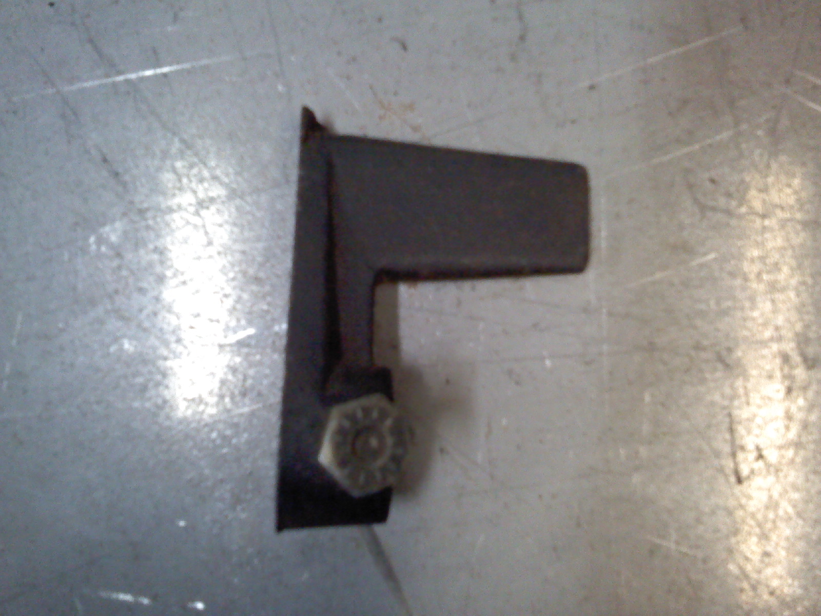

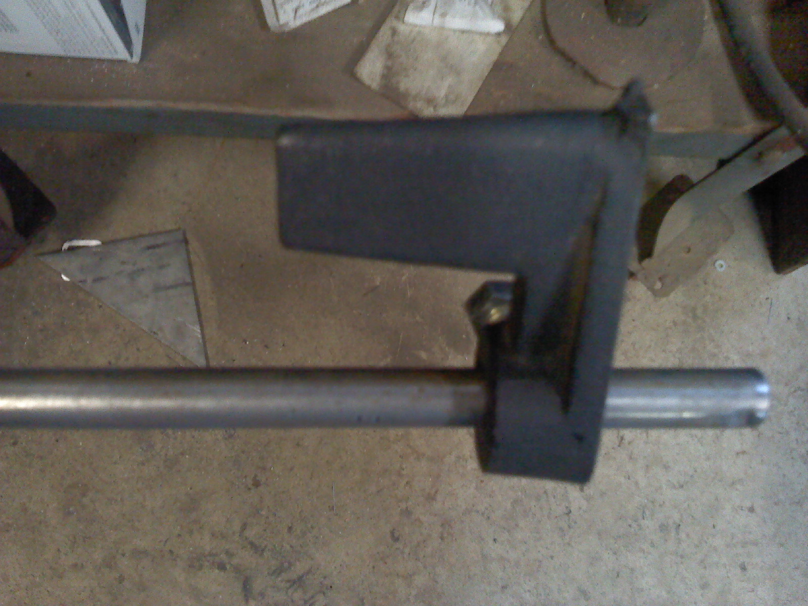

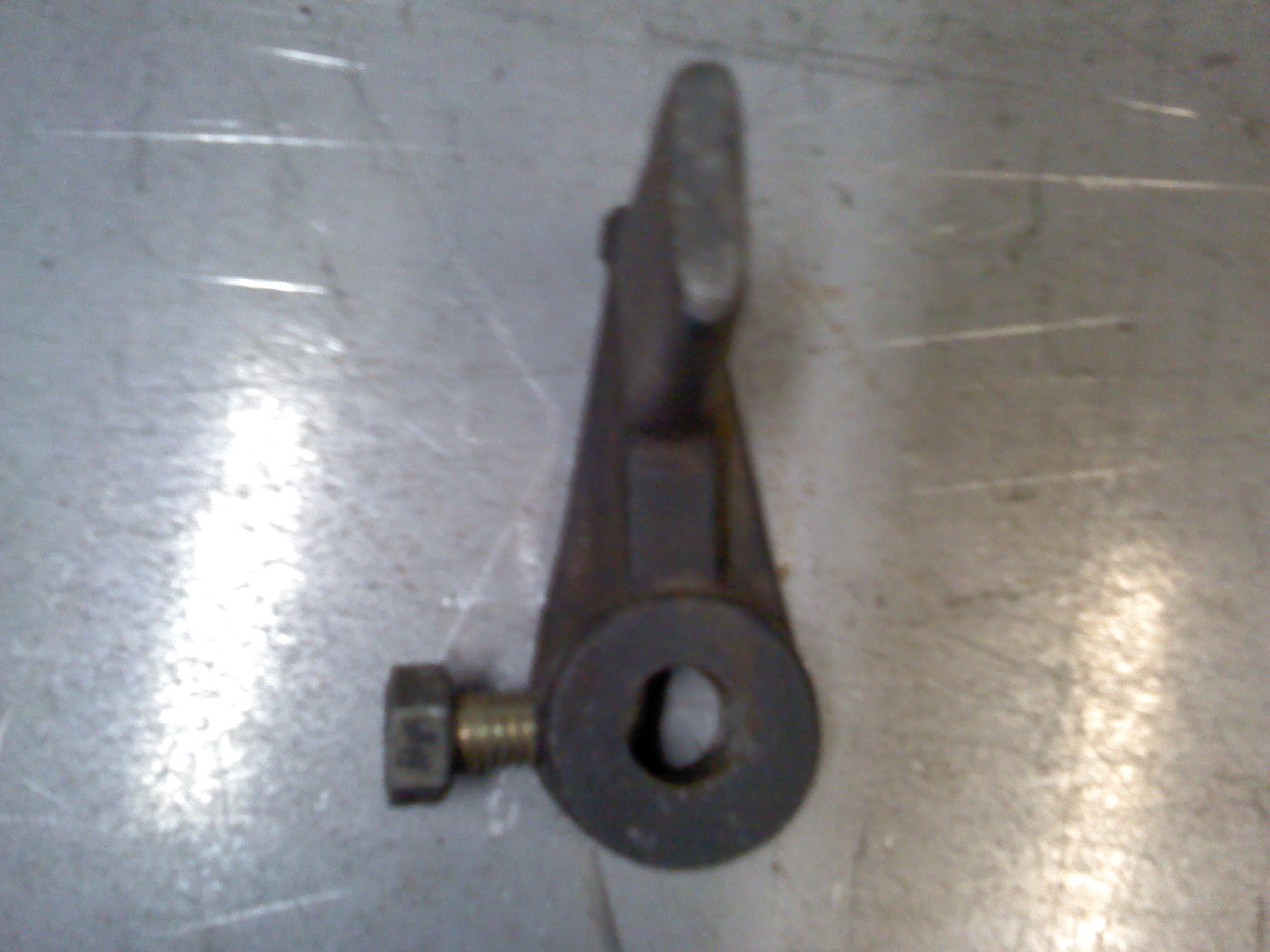

Here are some close up shots of just the stop. If you make one the inside length of the "L" is about 1.75 and you will need that to make small repeat cuts. It hangs over the table so you can get closer to the blade to make those smaller cuts.
Huge thanks for posting those pics. That will make the fabrication much better.
