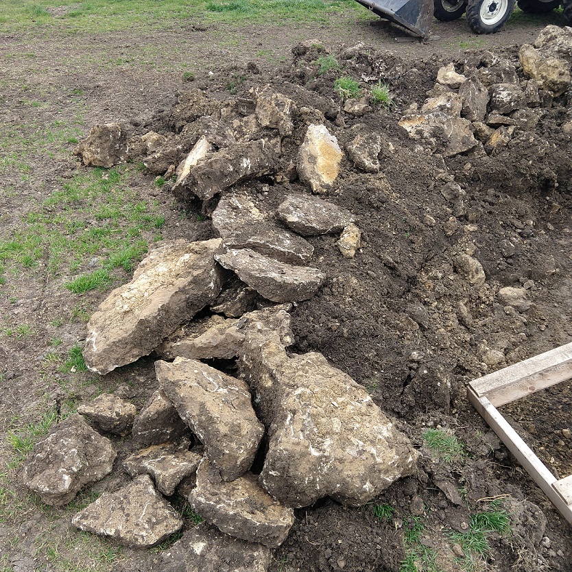

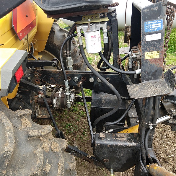

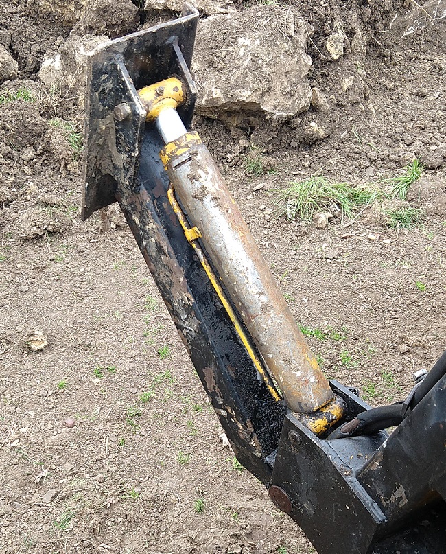

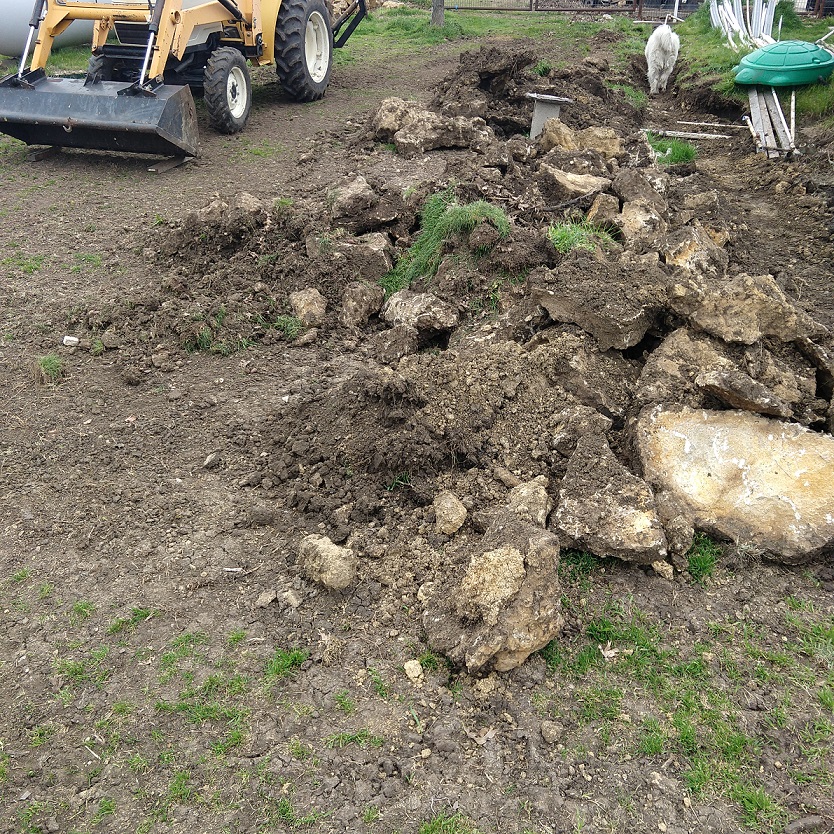

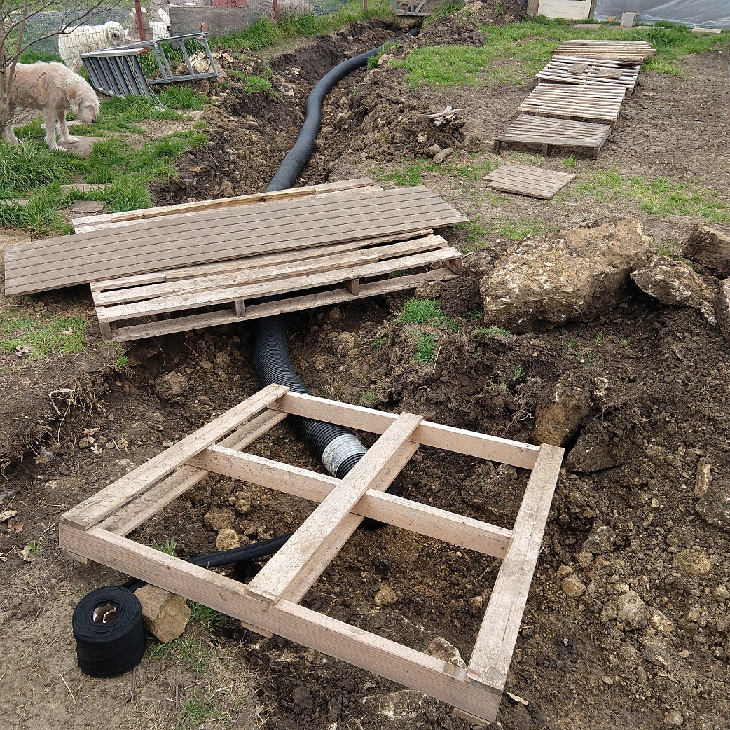

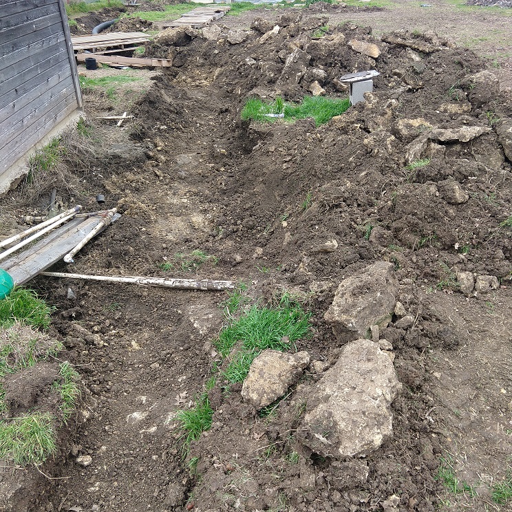

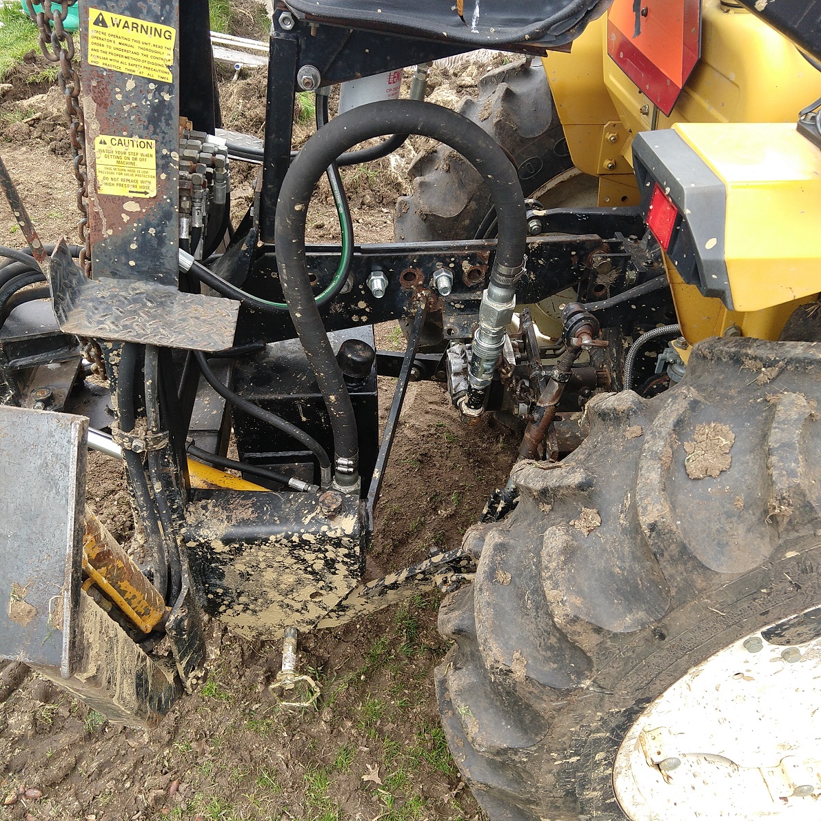

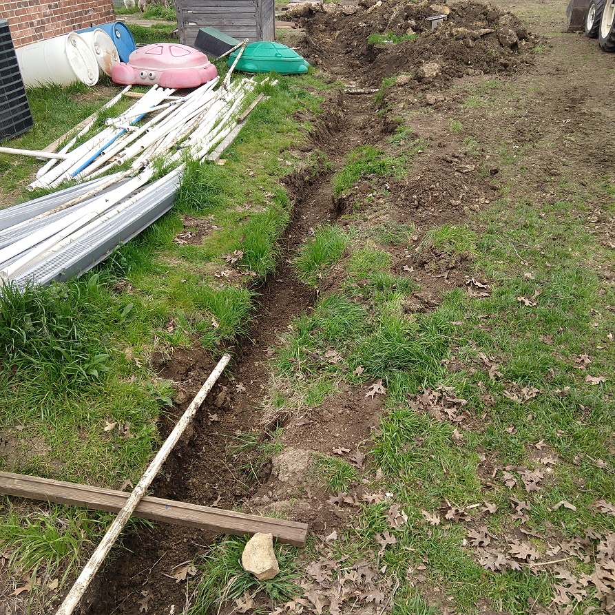

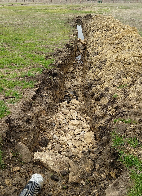

So, here are a few pictures I took a couple hours ago of my drainage trench - just in time for the next round of rain to show me how well I did for slope. A couple months back I had a little help from my son digging in the coop 'run'. The trench served multiple purposes, had to bury the machine cloth for protection vs. predators; laying the drain pipe; and the tetris-like stacking the stones Inna sorta filter like surround of the pipe.
It did show functionality through the stones while the pipe was "up" outta the way on either end of the coop.
In one of the pics you'll see a 2" PVC pipe. When I moved the propane tank I asked the company what size pipe they recommend for protection of the copper supply line to the house as I am finally getting to see the driveway planned and thus this will protect from driveway etc.
Yes the BH is a 3-pt setup still. I don't see making the sub-frame anytime this spring and with that I've been very careful to not push my luck.
I've discovered that the cub throttle control on the dash had a weak hold and will allow the RPMs to slowly drop. That being said, it's not a real issue with wheat I'm doing with the BH. The majority of time I have the PTO running under 50% max; the engine is running at most 17-1800 then over the next 20-30 minutes slowly drops to about 1100RPMs.
Right now I wish I had landing gear feet that swiveled.
The control handles do allow for gentle & very slow adjustments which was really great next to and on top of the PVC protecting gas pipe.

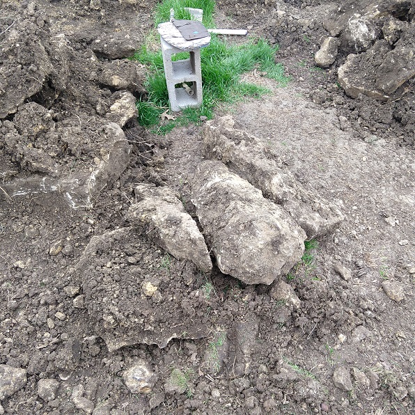

Used the backhoe yesterday to 'carve' out a flat spot for a propane tank install next to my garage/shop that I will be heating soon. Although the site is small, I couldn't dent it with a shovel and I'll be dammed if I going to pick up my pick again unless the world is ending. The rocky soil was like concrete.
Some say the BH is a bad ROI... I don't care. I smile every time I use it... and stuff gets done.
