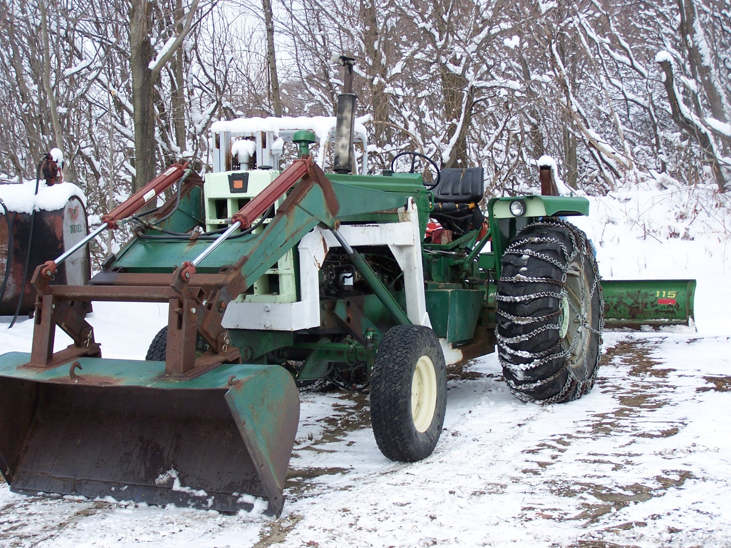

My place is on the side of a mountain... We have nothing but 2WD, and old... Amazingly, none of the equipment has slid to the bottom of the mountain to be abandoned because we can't drive it around regardless of the weather being wet, or icy.
Yes, 4WD would be nice, but seriously, it isn't the end of the world without it. Heck, I'd love a cab too, but sun, rain or snow, the open station machines continue to run, and do what needs to be done.

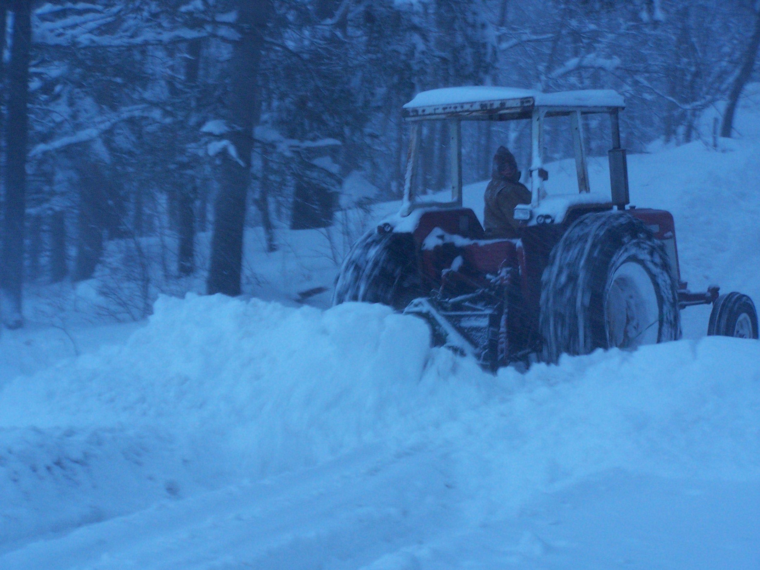

Can be done with 2wd, but 4 is nicer. 20+years ago
about the same time frame
again 2wd can do it

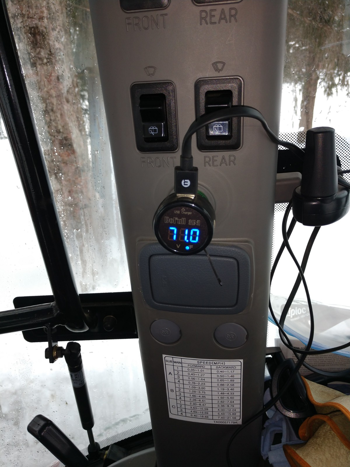

But much nicer and almost enjoyable, 2014-2015 time frame
when the front and rear blades were on and she's plugged in and warm.
Definitely much nicer it was -7F outside that morning

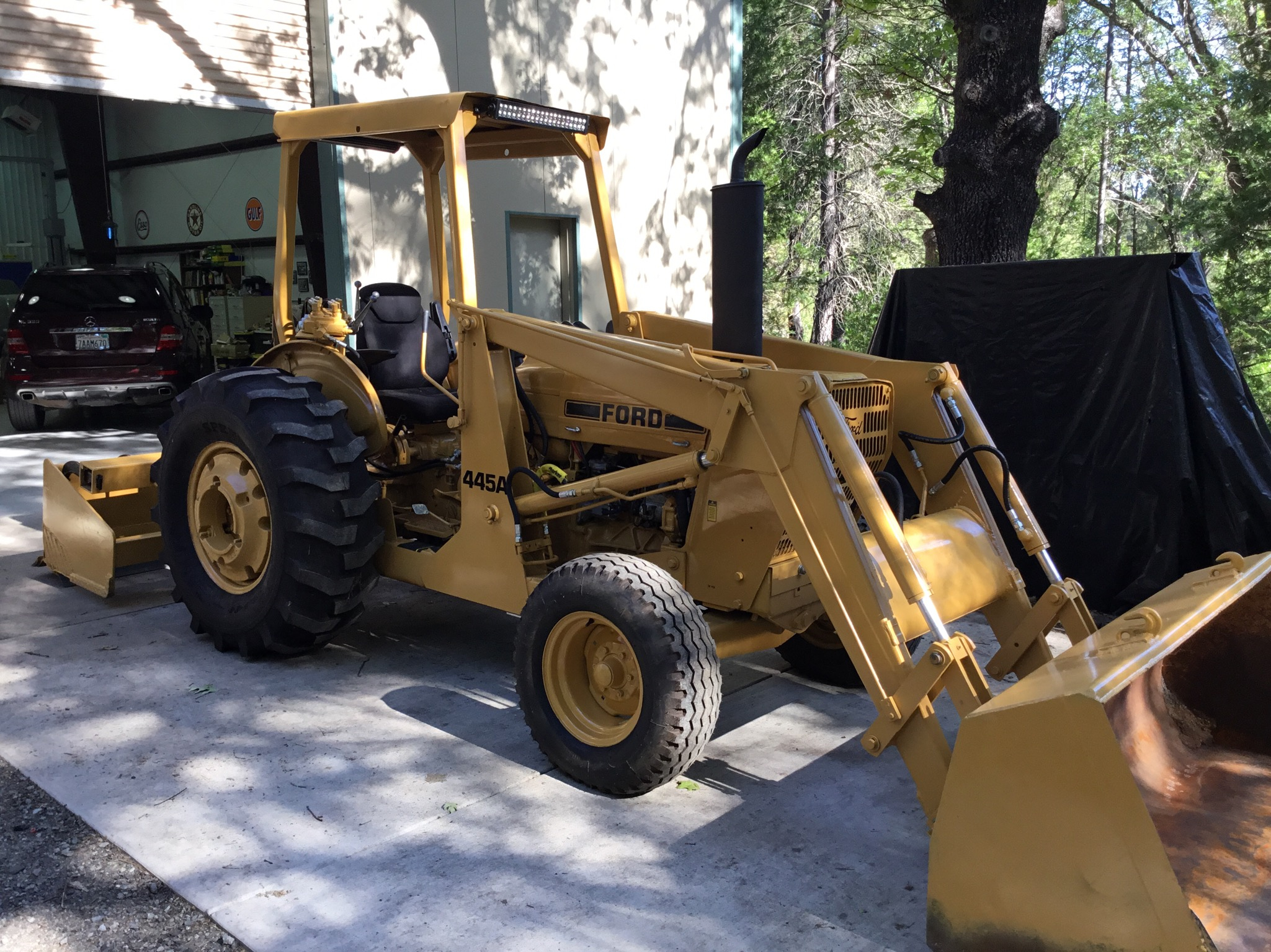

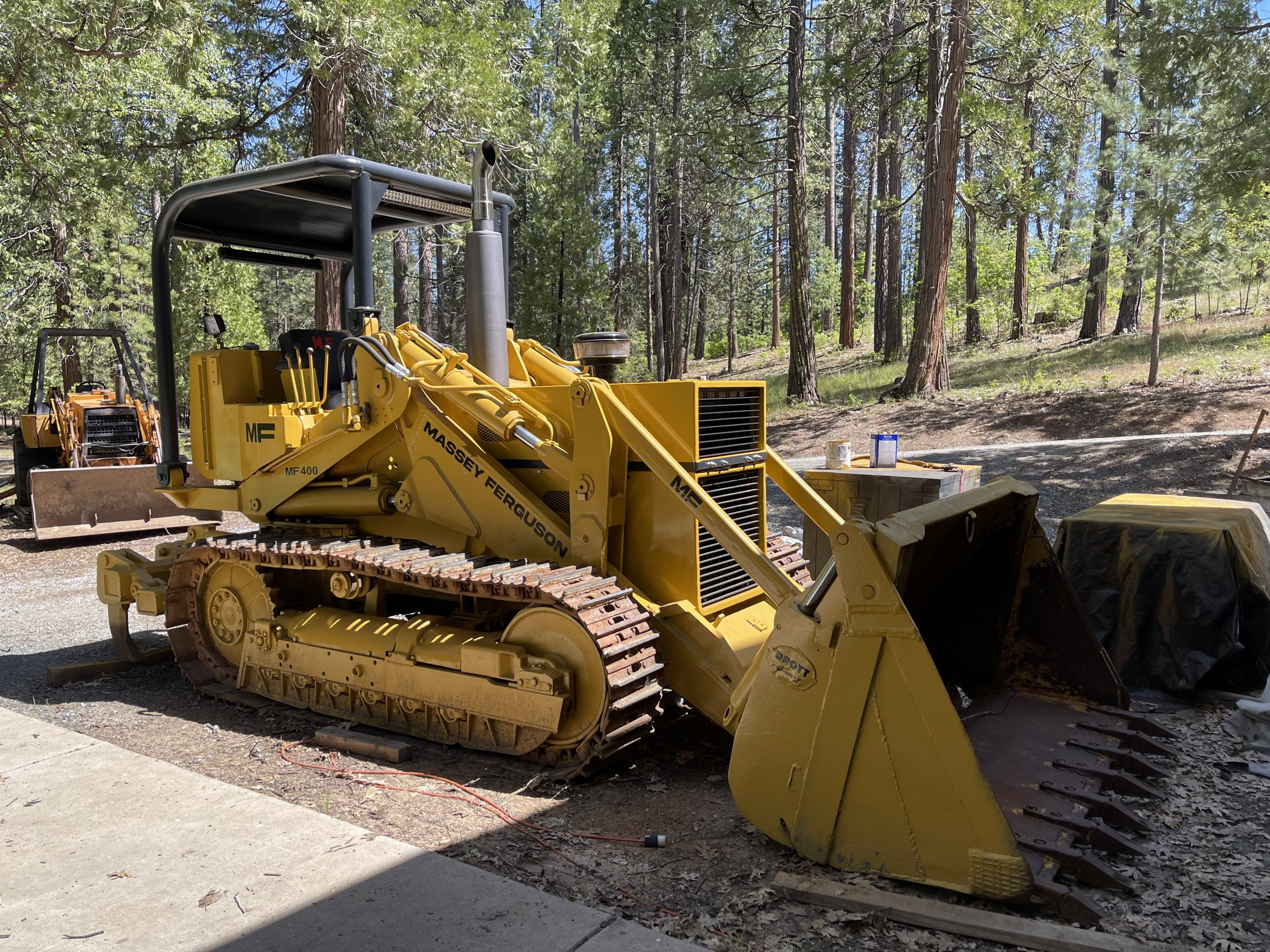

I once used a tractor loader from early Ford style. Not sure of the model maybe the loader was a 771. When the bucket was flat on the ground it didn’t curl back, you had to push into the pile and raise loader to get back angle. Useless.
Then I bought my first loader an Oliver 770. 60s machine? The loader was pretty strong and curled back well. Big clumsy machine but $2600. I rebuilt the backhoe and it served me well. As business was getting bigger and faster I bought a new 1985 JCB turbo with a 4 in1 bucket, good machine too pricey for your usage. Then I bought a used Case 750 loader, good loader but they came out with a wet brake model in 1986 855d Cummins powered, loader ripper. Now thats a serious loader. But again pricey. I also bought a Case W-20 wheel loader 2.5 yd bucket. Too pricey again. Now retired I sold all those and many others and got some different ones to keep on my property. I think the Ford 445A I have might be a good fit for you. Got it for $6500 with a Gannon box on the back. Needed some work but it’s fine for here. I also have a JCB 1550 B and that’s a good loader, and a 1975 MF400 loader/ripper which I have shown on this forum as I restore it. Very serious loader.
