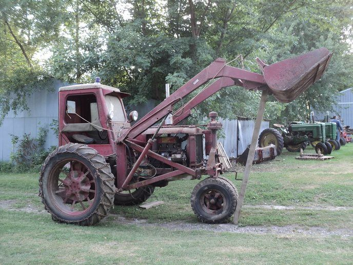

Older tractors can have a narrow front axle with the tire spacing very close together or a wide front axle. The narrow front imparts instability when a front end loader is attached. Some older tractors even have a single front wheel and not a pair. See post number 7 top understand what a narrow front is...
   / How old a tractor would you go if you require a front end loader? #18
Back in the early 60's we had very few wide front tractors in our area, small fields, stone walls.
The narrow fronts did better in field work with lots of turning and didn't run over as much crops or windrows in hay.
The only wide fronts that could come close to the maneuverability of the narrow fronts were the few setback ones,
and those had significantly less traction when working with pull type implements.
Therefore when we started seeing loaders on farm tractors most were on narrow front end tractors.
The first front end loader we had on the farm was an old JD mounted on a Farmall 400 a couple of neighbors had Farmall H's or M's with loaders these were all narrow front tractors with the straight tube loader frames and trip buckets. We were certainly glad to have these available, they were so much better then the alternatives. Loading manure spreaders with a 5 tine fork was a miserable job.
As far as them being wonky or unsafe, I don't believe so and I'm not going to get involved with any discussion of the tipping points and diagrams and arrows, it has been discussed in other posts by many people. And I suspect that most of them have never used or worked with a narrow front tractor and loader.
