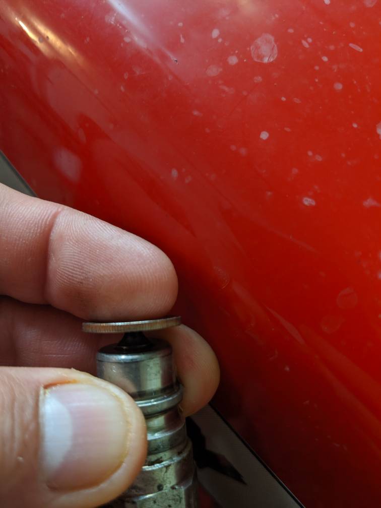

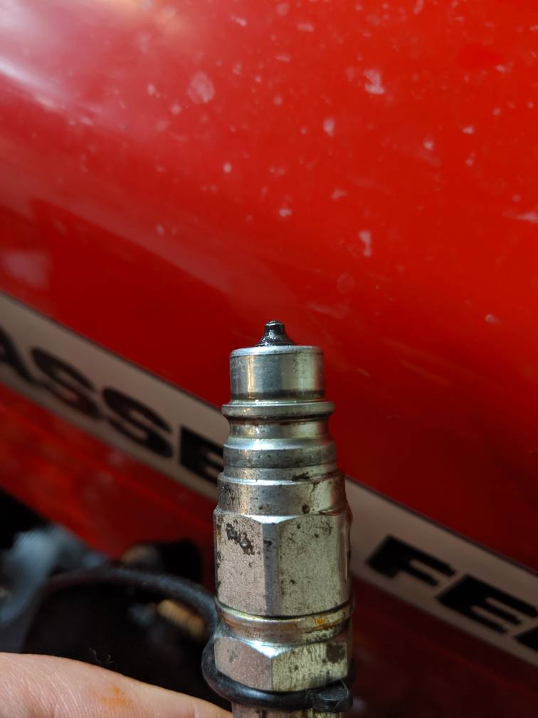

My 2015 GC1710 with DL95 has what appears to be 1/4" ISO 7241 - A series. Is this correct? IMG_20191001_203857.jpgIMG_20191001_203917.jpg

   / HOW TO: Adjust the Pressure Relief Valve (PRV) on the MF GC 1705/10/15/20 #57
That male coupler looks smaller than mine. Mine are 3/8". You may have the 1/4", here.
I would agree with you.
Pretty sure 2016+ they went with the larger couplers.
I have the 1/4” on my 2015. Curious if it would make much of a difference to flow rate changing them to 3/8” ? Must have been some reason Massey changed them to a larger size.
   / HOW TO: Adjust the Pressure Relief Valve (PRV) on the MF GC 1705/10/15/20 #58
Mine is a 2015 and I can confirm I had 1/4" fittings. I would expect a smaller size means faster flow as the pump volume is the same regardless of fitting size.
