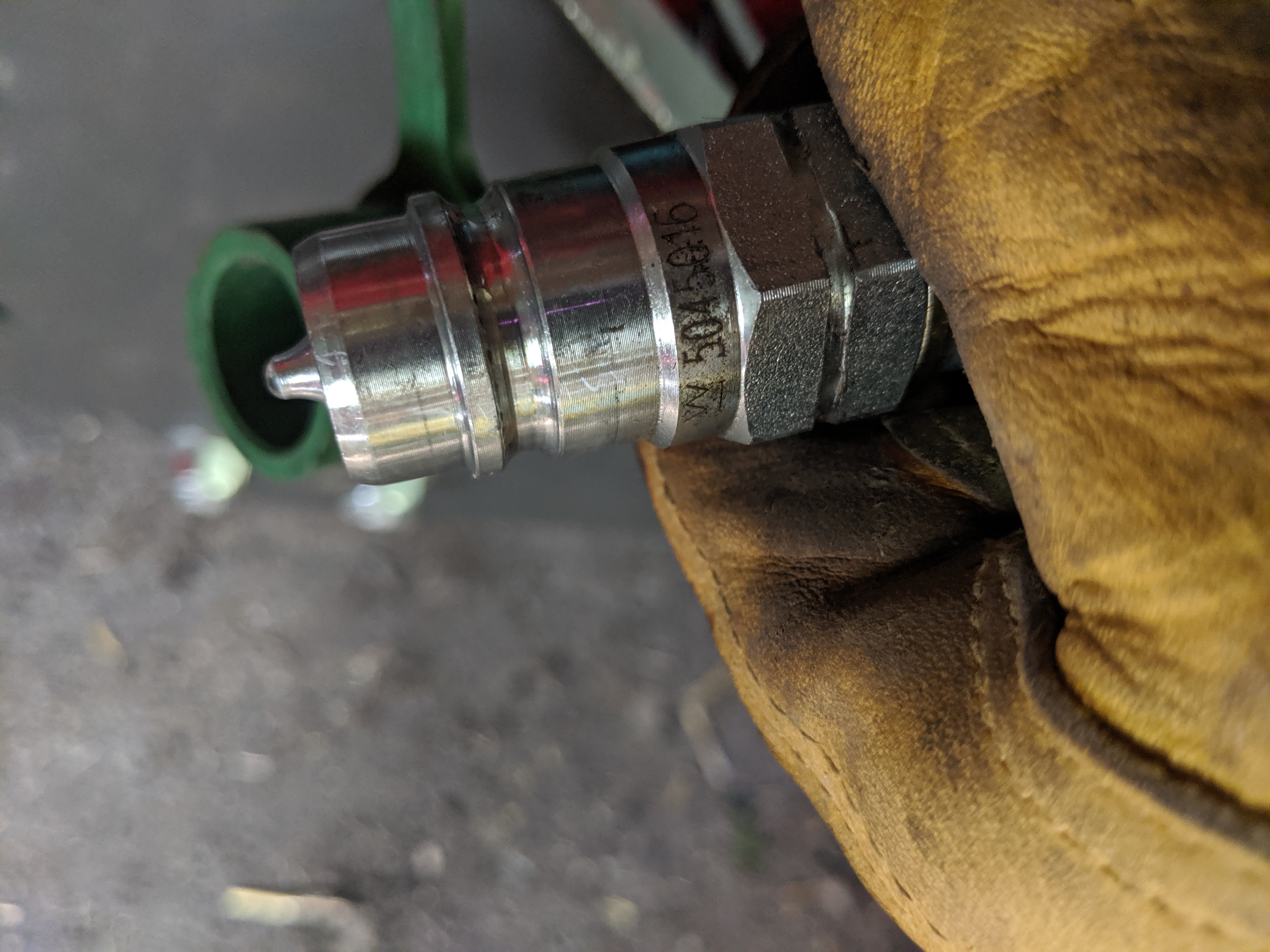

It seems my year old GC1710 doesn't use the 1/4" connection. I ordered the 1/4" AG and it is smaller than what's is on the FEL connections.
Here a picture of the 1/4" connection on the gauge next to the #2 connection to the FEL. And now I see how they seal.....thanks to all that replied.

I just sent you an email, I think you have 3/8" ISO 7241 "A" couplers.

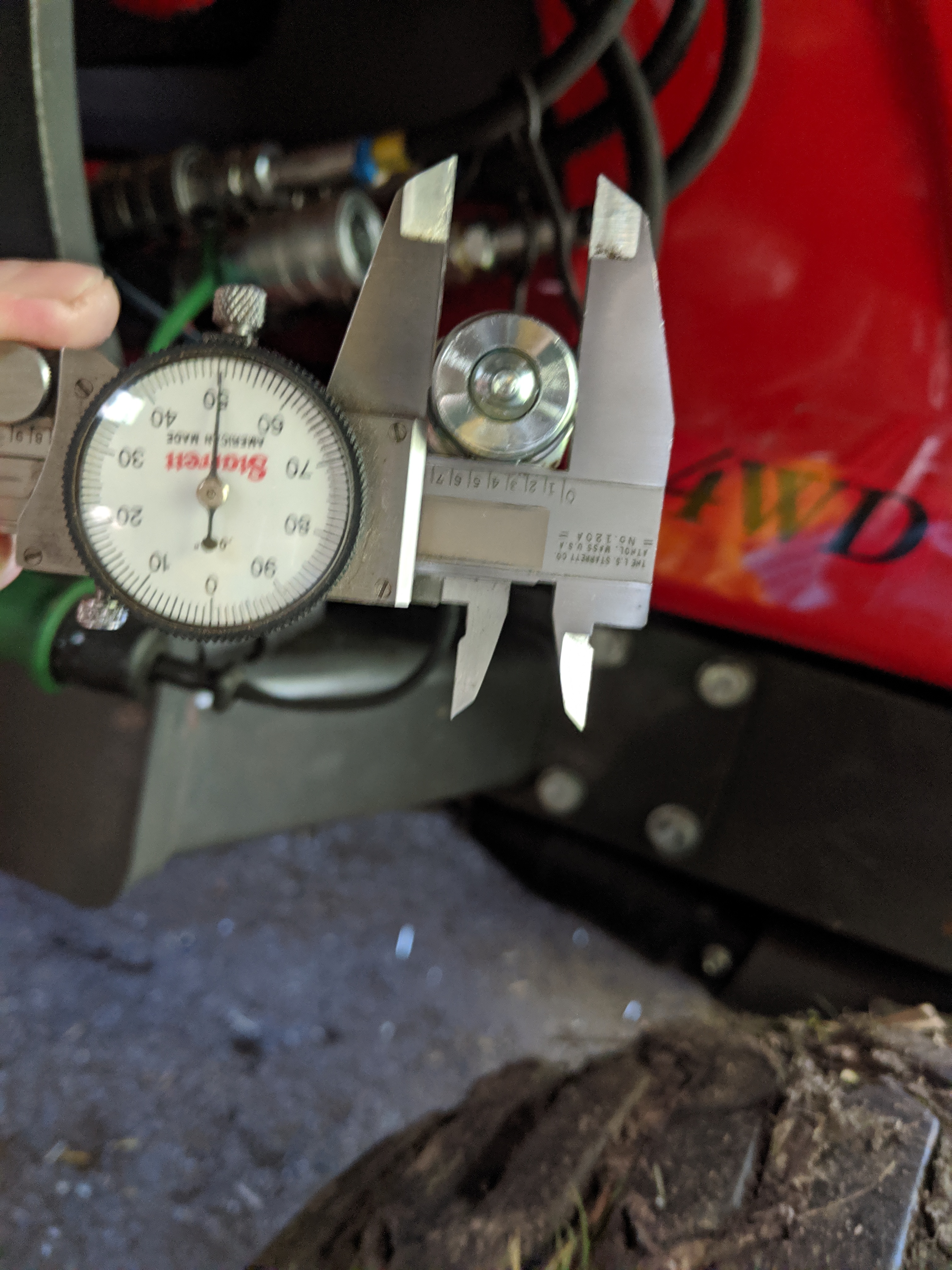

Kenny, I want to order your valve, what coupler size do I need? I have a 2018 GC1710. To the original poster, great write-up, much appreciated! My loader seems to struggle so I'm holding the prv suspect. I'm also getting hydro squeal and the drive seems a bit anemic when pushing down on forward, so wondering if that's related.

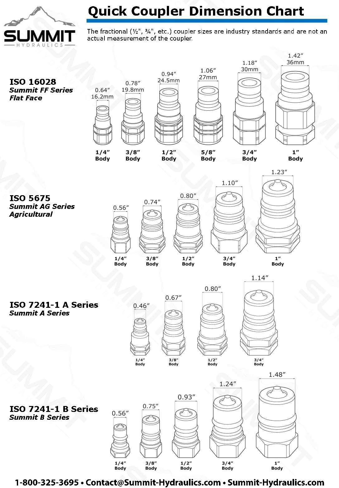

We now have three charts on the website that you can download, print out, and compare. The GC1705 uses 1/4" ISO 5674 "AG" style, not 100% sure if the 1710 uses the same-it's to hard to keep track of all the modle numbers form every manufacturer.
   / HOW TO: Adjust the Pressure Relief Valve (PRV) on the MF GC 1705/10/15/20 #48
I would think it be the same thing on the 1710, but just in case what do I measure? I got 3/4" on nipple diameter. IMG_20190924_133344.jpgIMG_20190924_133211.jpg
Those charts on your website did help, and yes I do think that's the one I need as well. Your website says to email you about that size coupler, so I guess I'll do that before ordering.
