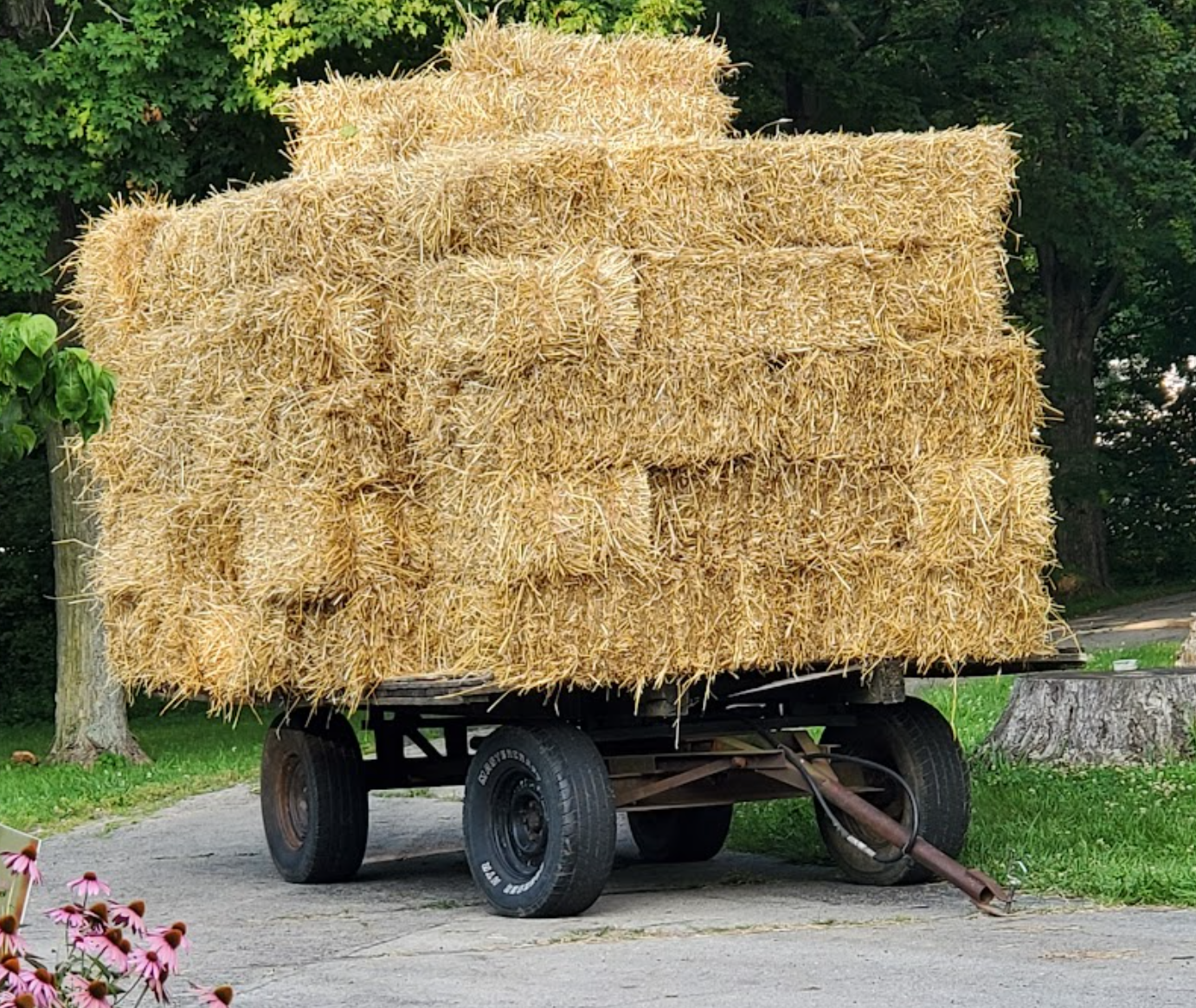

I just got an utility trailer with two axles. The front axle pivots.
The tongue is A-Frame. It looks just like the photo attached.
While I am normally pretty good at backing up trailers -without pivoting axles- I find this one is just about impossible to back up. I don't know if it's because the tongue is too short or if it is the double pivot point that screws me up.
So for those of you whom own one of these how do you back them up?
Do I need to lengthen the tongue?DO I need to rig it so I can tie the 3-points lower arms to the tongue or do I need to fit something to lock the tongue at the 0 degree position when backing up?
Thanks in advance.
Independent rear brakes are your steering help when trying to back up a wagon. Learned at 12 years old working on a vegetable farm backing them multiple times daily up To a loading dock with other tractor/wagons alongsid. A knob (suicide knob) bolted onto the steer wheel helps immensely too. So unlock them rear whee brakes and give it a try.
