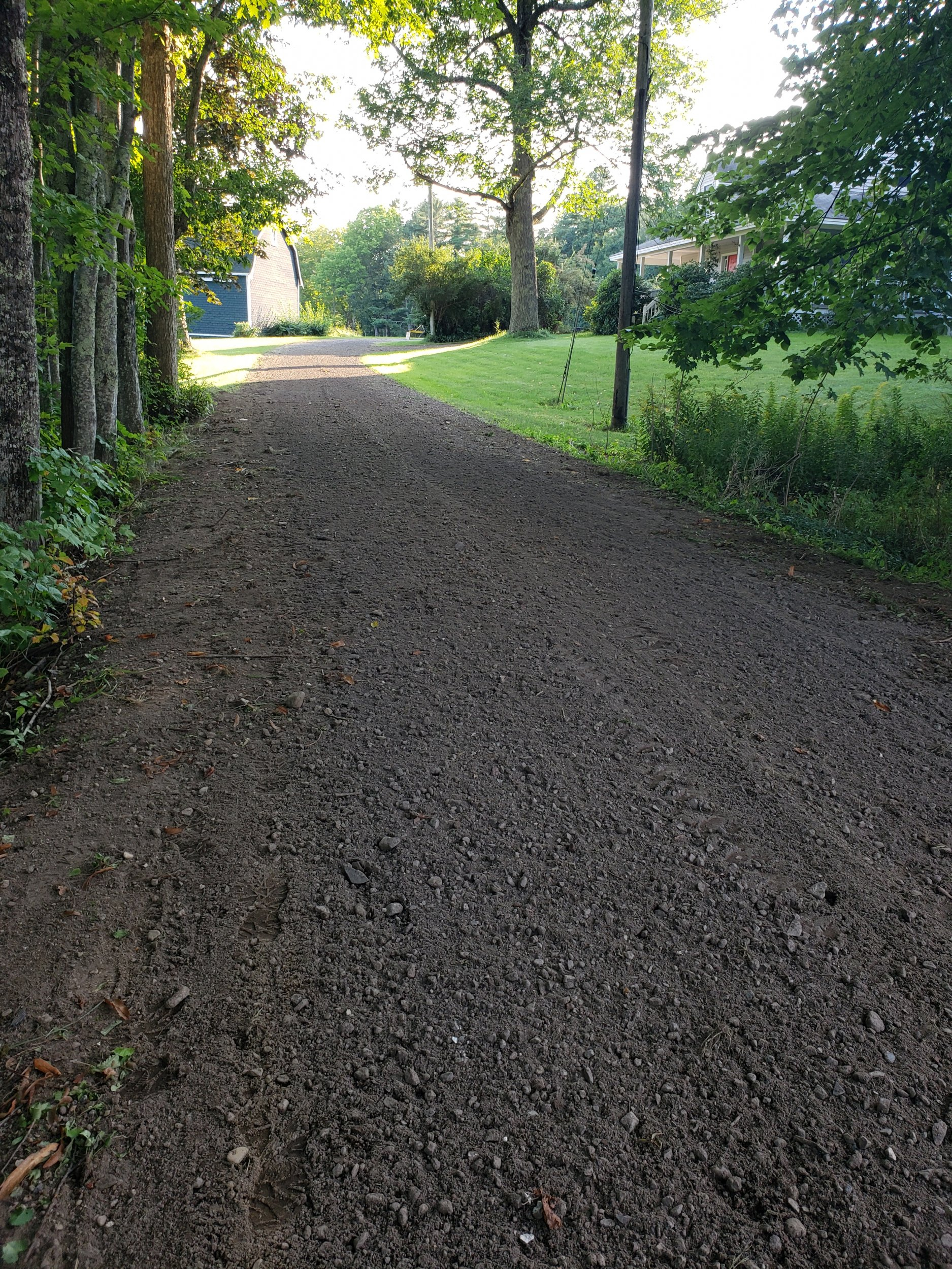

I don't have draft control but yesterday re-worked 300 yards of driveway that hadn't been graded in several years. The aggregate is 3/4" crushed concrete asphalt shingle mix.
First I used the aggressive side of a rear blade to angle the edges of the drive back towards center. This put back gravel I had been snow plowing off since winter.
Then I put on the Box Blade and dropped the scarifiers and shortened the top link all the way, then used the lift control to just rake the scarifiers across the driveway with as many passes needed to loosen everything up. I never let the blade touch the driveway with the lift control.
Then I pulled up the scarifiers and extended the top link all the way. This allowed me to pull the BB across the loose gravel to smooth it down.
Final touch was to use the non-aggressive side of rear blade to angle gravel from the side to the center to form a slight crown.
Good results for several hours of work and I only used simple top link adjustments and lift control.
