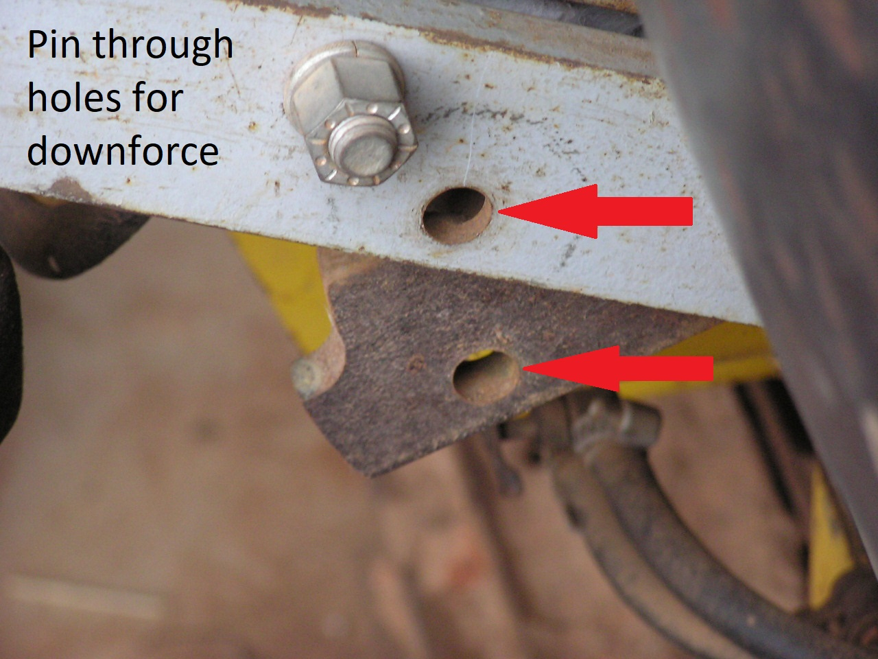

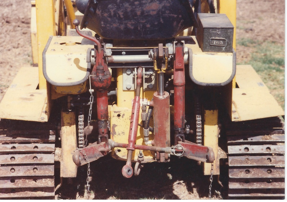

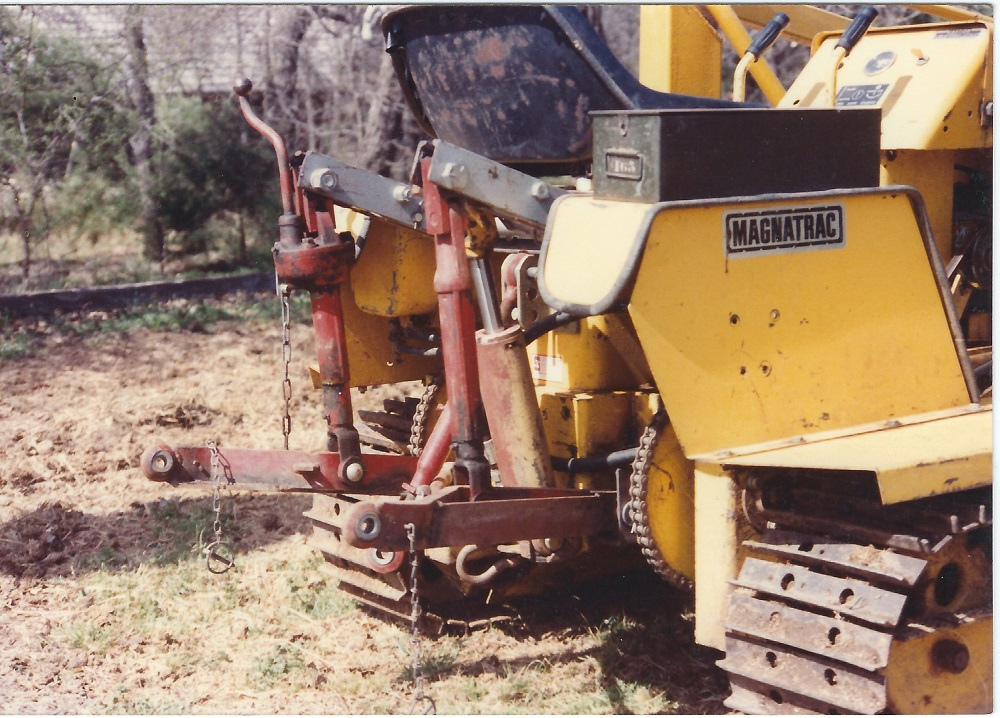

Quite true -- all 3pt hitch systems I ever saw use hydraulics ONLY to lift and go down on their own only by gravity----------------------------
Now you can see pictures of a 3 point hitch that I built back in 1990 that has down force if needed by inserting 2 pins in the holes:
Downforce works because of the tracks, not rear tires:
