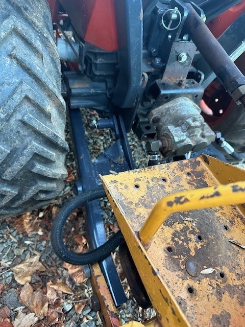

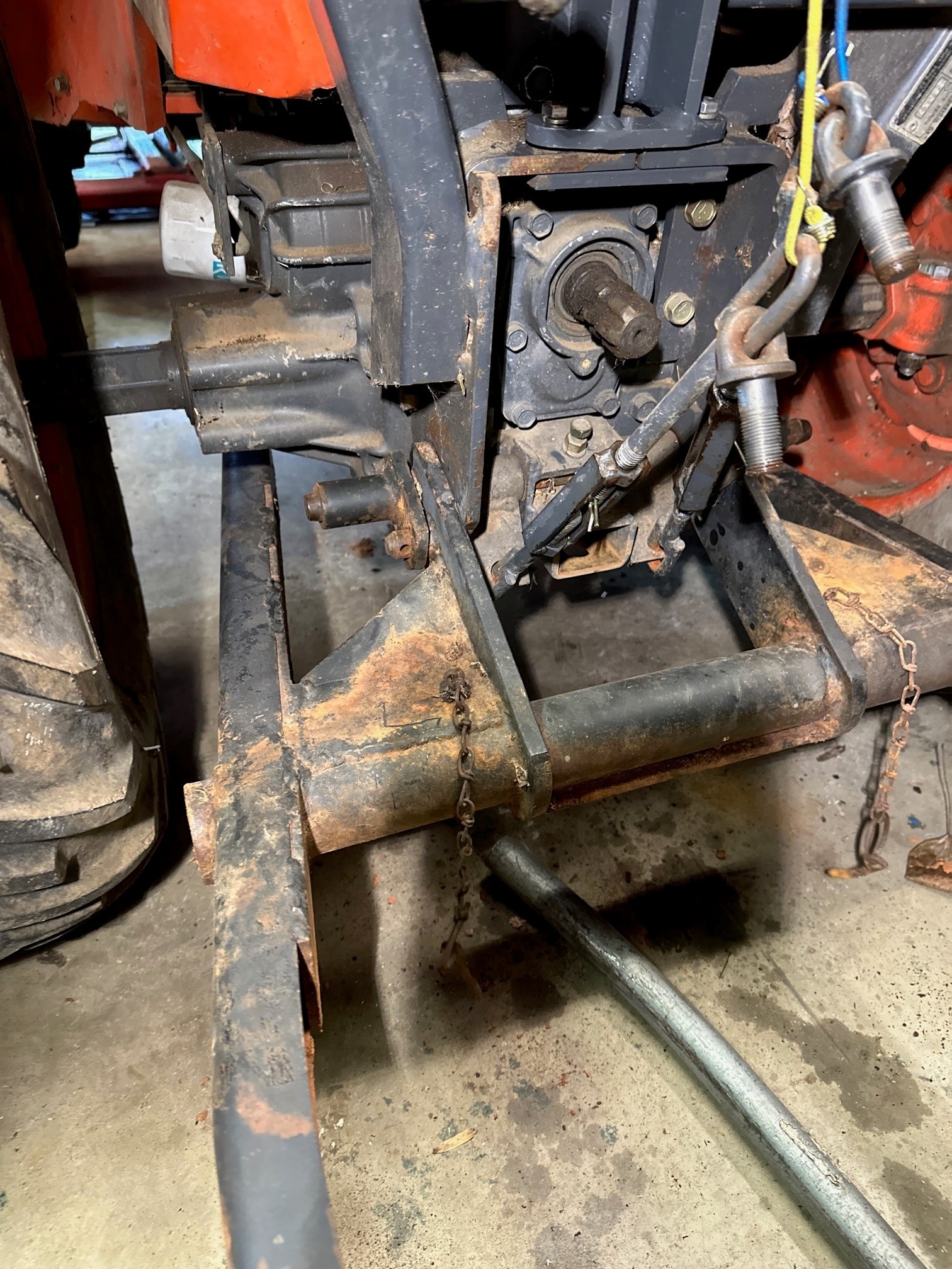

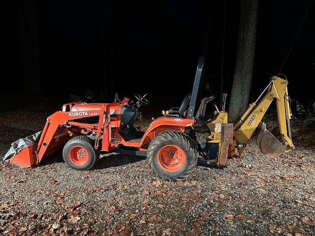

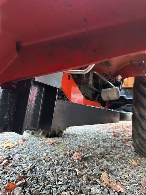

Sorry for the long delay. I finished the backhoe subframe. It's a woods bh650 to B2400. I ended up using part of a woods subframe for a b7800 I think and then extended it to my existing FEL as it has some brackets already welded on that worked great (see pic). I used 3x1.5 channel in 1/4 for the extension and 3x.25 plating as reinforcements. Rear height is 9 inches to the bottom of the subframe.
This design uses the existing 3pt rod in the rear and hangs on it. The 3pt arms have to be removed to install. I painted it kubota bright II orange and then cut some labels to match (and yes I kept the OEM stickers on the base as well as cutting a new Woods for it too :) . But I liked the Kubota on the boom so that I left.

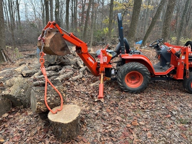

As a side note it works fantastic for cutting firewood out of heavy logs. I chained a logging grapple to the bucket and am able to pull around and lift 12-24 inch diameter logs in considerable lengths. I then just buck them when in the air. I used a boom pole for this last year but the hoe is much faster as it can maneuver itself as the boom pole required the tractor to be moved around instead.
Paid $1500 for the hoe, $200 in metal... and $60 in paint.
