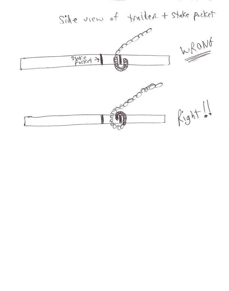

Use the axles. Do NOT use attach points such as the 3PT arms, implements attached to the tractor , loader arms, steps, weight brackets, etc
Use four chains and four chain ratchet binders with grade 70 chain. The difference between cheap chain and grade 70 is probably less than $20 for a typical tractor & trailer combo hauling a compact tractor.
Always loop your chain down through the stake pocket and then back up to hang vertically on the stake pocket. This way, if the chain ever loosened a little bit, gravity will keep it in place and your load safe. If not, you run the chance of the chain completely coming loose.

gordon21's picture drawing #2 is correct but if you have a long enough chain why not continue through the stake pocket and hook the chain back onto itself. The tie down method I use is to go through the stake pocket / or D-ring and back up with one end. The other end of the chain goes over the tractor front frame then I connect the two chain ends with a ratchet binder. Same scenario on back, 1 chain and binder at each corner of tractor plus any implements
   / How to chain up the tractor? #10
"The tie down method I use is to go through the stake pocket / or D-ring and back up with one end. The other end of the chain goes over the tractor front frame then I connect the two chain ends with a ratchet binder."
When you take up the slack in the chain does the chain not need to be able to slide along the stake pocket and tractor? With this method the chain tension only needs to be half since you are doubling your pull. I suppose we all tighten to 'good-n-tite'.
I do like Gordon21 with the stake pockets. So far they have not been deformed by the tension. I was at first worried that I would need to weld big old d-rings to the trailer frame but was assured that the stake pockets are quite strong. So far so good.
