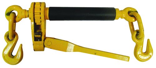

Where do you guys typically buy your chains and binders? Is 3/8" the 'standard' size for the CUT's? Do you buy the ready made chains with hooks or do you buy the chain and hook separate? What typial length do you buy when using one chain at each corner? I have been using two chains and manual binders for mine but after reading through these posts want to set myself up right with new stuff and want to get the most bang for my buck.

I would say that for most CUTs 5/16 should be plenty, unless you have a really large machine. You can get chains and binders at Tractor Supply and the like or order them online. I got my chains from a friend who started hauling an excavator so he stepped up to 3/8. The binders I got from Erigging - Catalog .

For length 10' seems to be the norm. Mine were 2 20' sets that were cut in half and extra hooks added. If your existing chains are long enough, you can just do that and just have to add binders. Technically you don't even need the extra hooks, but I like to wrap mine around the binder handle and hook the end on the chain to keep things from flopping around.

The best straps I have found are Mac's. They too are 10,000lb rated but are very well made. I have a complete tie down kit from them I use for my Polaris Razor.
For a tractor I would use chains. I can't think of any reason not to use chain. 5/16" grade 70 has a working load limit of 4,700lb. It is actually cheaper in the long run because it doesn't fray and wear out. I am using tie down chains and ratchets I bought over ten years ago.
To tie down a tractor buy two 16' chains and cut them in half. Buy four extra hooks to put on the cut pieces. Buy four ratchet binders. You will be good to go. It will cost around $160 but your tractor will not be going anywhere and it will last a lifetime.

I use chains and folding handle ratchet binders.
