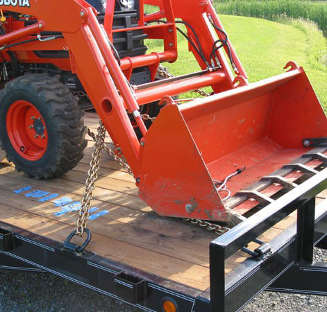

I use chains and feel comfortable that way. I would only add to the other recomendations that you make sure you buy USA chain and hooks. I've heard of stress breaks on the hooks from China.
In addition to the rear and front tie downs I add a safety chain to the front axel going to D rings on the trailer bulkhead, then I drop the FEL over it. This provides extra safety against rolling backwards, the bulkhead would stop forward roll.
