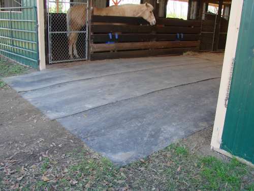

Today I tried to cut a scrap piece with my old chain saw with a blade that wasn't too sharp. I got a little smoke, the belt and chain heated up a lot and the chain got so loose I had to stop. I cut about 2 inches. :( I think I have to keep it wet down as I cut with water or a lube such as diesel. I am going to sharpen my blade tomorrow, tighten it and get my wife to spray the belt as I am cutting it and see if that works. I'm also going to get that jigsaw blade with the knife edge and try it.
The photo is the belt in my barn used as floor mat and showing the small strip I have to cut to finish the job. It's actually 66 feet long because I have it extended out both ends of my barn about 3 feet.

Have you tried the battery powered skill saws with a knife edge blade. Spray the cut line with water and cut away. A meat slicer blade might work.

I laid conveyor belt down in our barn. About 3/4" thick, very tough, heavy material. I picked it up from a quarry operation where they used it to get rocks/etc out.
I sprayed the mat down with WD-40 first where we wanted to cut, then took a razor blade, scored it a couple times and it cut easily. It was actually easy.
You can also use a reciprocating saw.
