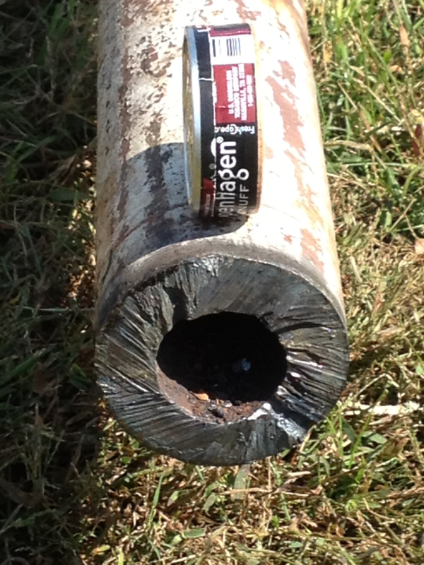

The torch happens to be my favorite way to cut steel.
Not my cleanest cut ever but it gets cut again for elevation. 1"
