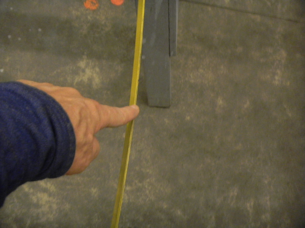

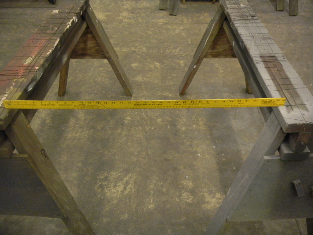

Beams deflect first, then fail. The main reason you see H shapes is to avoid deflection.
A good old welder ounce showed us a trick. He showed us that if you could stop a piece of paper from deflecting it would support a huge amount of wieght. Just think about making a header, two 2 by 10's. Now put a layer of tin between them, huge strength increase
My point is, it's the deflection that leads to failure. Looking at the original posters picture, I would add a couple mid field 1-1/2 angle braces welded to the top and bottom rails. This would spread the load, and stop the expanded metal from deflecting and pulling on the perimeter.
