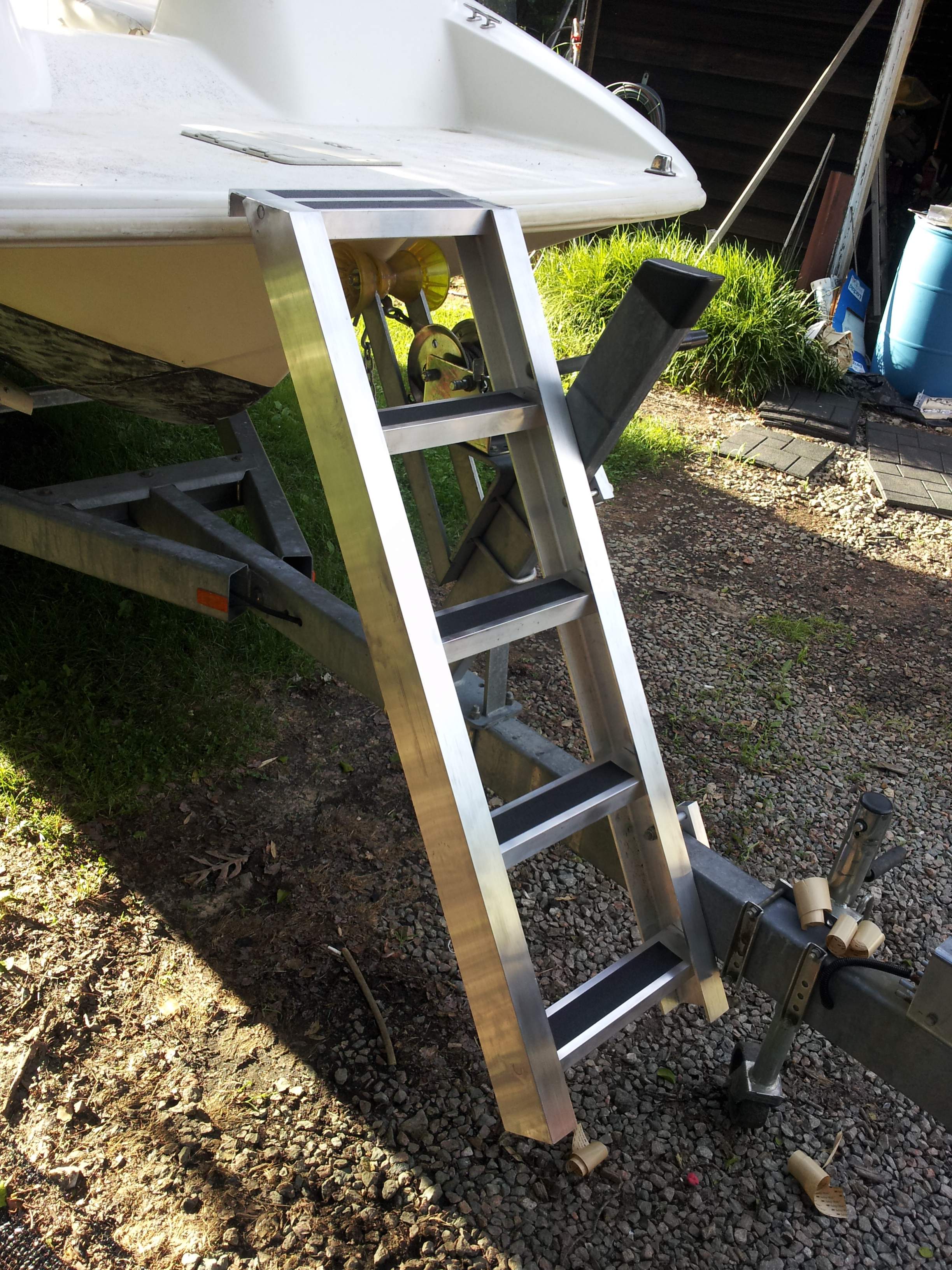

The big thing here is I would like to know how to be a bit more scientific about designing and building things so that in cases where size, or weight matters, I can make the right decisions. No, there are no space shuttles or sky scrapers in my future, but some small time engineering so I can build cool things like I see in these forums.
Here's a pic of the boat trailer ladder I designed and built from aluminum this summer. I experimented with that by cutting up an old step ladder and clamping it onto the trailer. After I saw how badly it would twist when a little weight was added, I decided to make it out of 1/8" x 1.5" x 3" channel. It turned out really nice, and clamped in two places on the trailer, is solid as a rock.

Just recognize that some of the projects you will see are over built simply to add weight to the implement. For your ramp I would guess that that 1.5x3.0 rectangular box tubing with .125 wall thickness would work for you and still be light enough to lift easily.

The problems with the angle is that it doesn't put enough material far enough away from the centerline. W flange beams are the stronest for a clean loading situation, but they are hard to connect. Pipe is OK, but the amount of material parallel to the centerline is minimal. Square tube has the max material parallel to the centerline so it's strong and the square shape is easy to work with. For your application, some channel would work nicely. Flat face is easy to weld and it still has significant material parallel to the centerline. The disadvantage to a channel is that it's not symetrical around the Y axis so it will be prone to buckling. That said, it'll still work for your application. Don't forget to make the lap connection long enough to restrain the rotation at the conneciton points.
