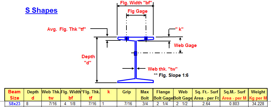

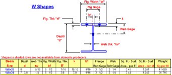

So why does the same height W-shape take more weight than the same height S-shape?
Because it places more material from the center line.
