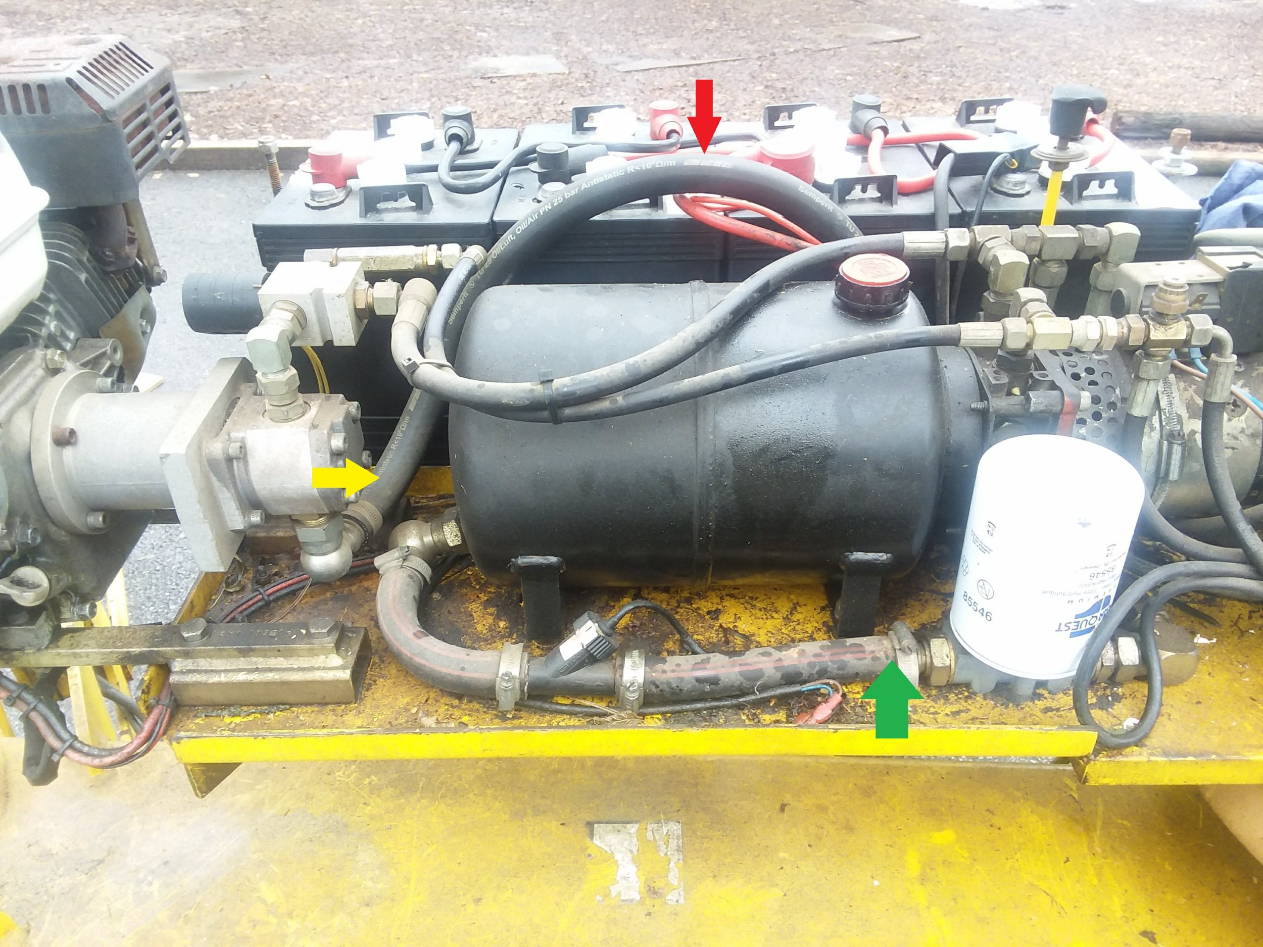

Here's a picture of the suction area:
There are two motors that can drive a hydraulic pump, the gas engine and it's pump are on the left, the electric motor is attached to the right side of that black cylindrical reservoir tank. The electric pump is inside the reservoir so it's not visible. Yellow arrow shows where suction line enters gas driven pump. Green arrow shows where suction line enters hydraulic filter base, red arrow shows the suction line that comes out the right side of the hydraulic filter base but is very hard to see because it makes a sharp turn to go under the electric motor. So there is a fair bit of suction plumbing that could be leaking. I've checked in the tank frequently and never see any evidence of foaming or entrained air. The tank is the only place in the system where the fluid is visible. The fluid level is correct, also note the only double acting cylinders are the stabilizers (and the leveling system), the lift cylinders are all single acting. I don't think that matters with respect to this problem. There is also a hydraulic motor that rotates the lift. If even a hint of air entered that motor it would be easy to feel a stutter in the rotation, and I've never felt anything.
The other part of this that makes it feel like an air problem is that I've had the lift for 8 years. When I got it, it displayed very slight shuddering in the cage leveling circuit, and when I bled the air it stayed good for a long time (days). Over time the problem has progressively gotten worse to the point where this year it also started this drifting behavior when the pump is off. So it really feels like a small air leak which has gotten progressively worse with time. But it could also be some other hydraulic component that has gotten progressively worse with time.

Interesting thread. Oldnslo is giving great advise. That is one seriously ugly suction plumbing. Upside down filter? Suction line with a loop higher than both the pump and tank? Surely the factory didn't do that. May not have anything to do with your problem, but how do you ever get all the air out of that?
