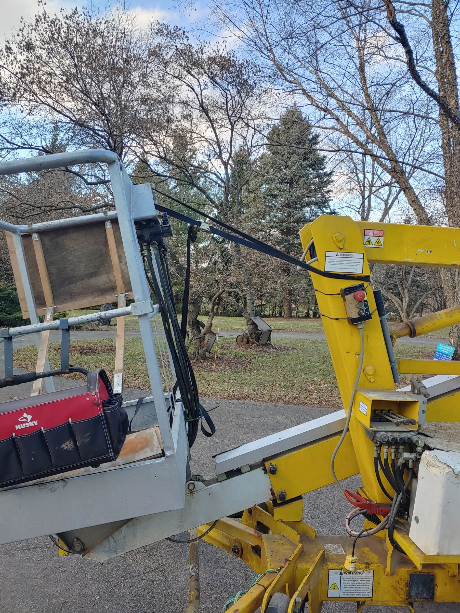

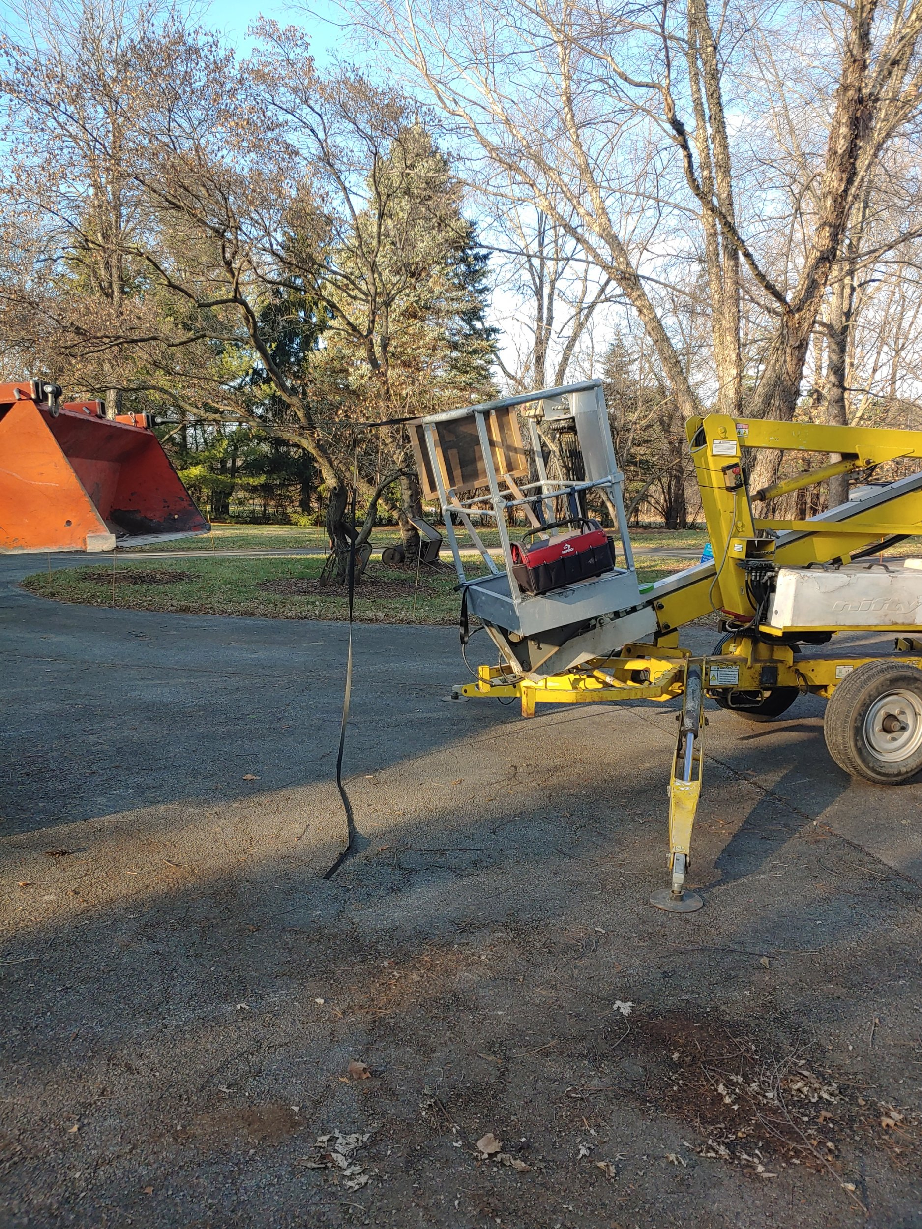

Did some testing, to force the cage leveling cylinder to extend I used a ratchet strap attached to my tractor bucket to pull on the top of the cage:
I attached a strap to the lift to force the cylinder to retract:
I put a piece of painters tape on the rod so I could see what was happening:
When I force extension, the rod extends about 1/4". I released the strap and waited, the rod extended another 1/2" and then didn't move any more.
When I force retraction, the rod retracts about 1/8". I release the strap and waited, the rod EXTENDED about 1/2" and then didn't move any more.
So in both cases after pulling on the cylinder to extend and retract, it drifts in the extended direction after I release it. The weight of the cage is trying to make the rod retract. So the fact that it drifts in the extend direction means there has to be a force on rod end of the cylinder.

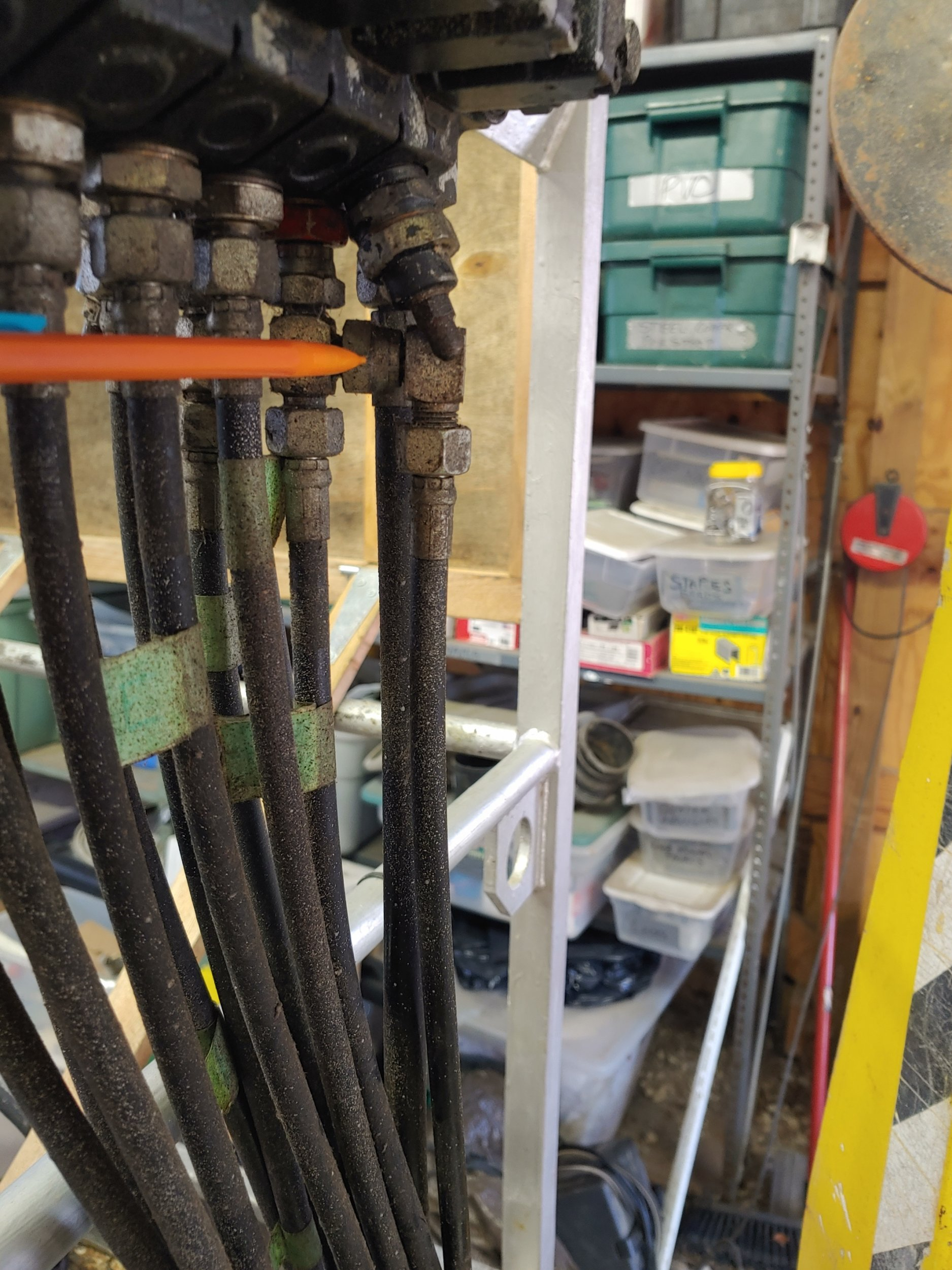

Beez,
From the amount of cylinder movement it does not sound like there is a excessive amount of air trapped in the cage cylinder. But the really puzzling thing and potentially a big clue is the extension after releasing the external load in both directions. I am just trying to visualize what could cause this extension to occur.
Couple of more questions:
1) The pictures looks like a hard line on the rod end going back towards the cap end of the cage cylinder. Does this connect to a block on the cap end or to the cap that have a valve in it? Trying rod determine if the PO check is hard mounted to the cage cylinder.
2) Any idea where the over center valve is mounted? should be in the rod end line with a hose or line connected to cap end. Possible in one body at cap end of cage cylinder.
3 ) same with two relief valves set at 145 Bar. Are they separate line bodies or in a common valve body. Not sure if these are in play but trying to gain a fuller picture of how this is plumbed.
Reason for questions above is trying to estimate trapped oil volume while doing the manual tilt test. The PO check should stop all flow out of the cap end and it appears the check did stop movement.
The over center valve could allow flow if you applied enough force to over come the preset pressure setting. At least the schematic shows having this pressure to open feature. Now the $64 question is where could any oil getting past the over center valve go?
Another off the wall question: Do you see any free play in the knuckle cylinder mounts? I.e. can it extend and retract without the main mast moving? Again doubt there is but trying to eliminate potential sources of unknown movement.
Sorry for all the questions but hopefully they will help guide us to the root cause of this problem.
