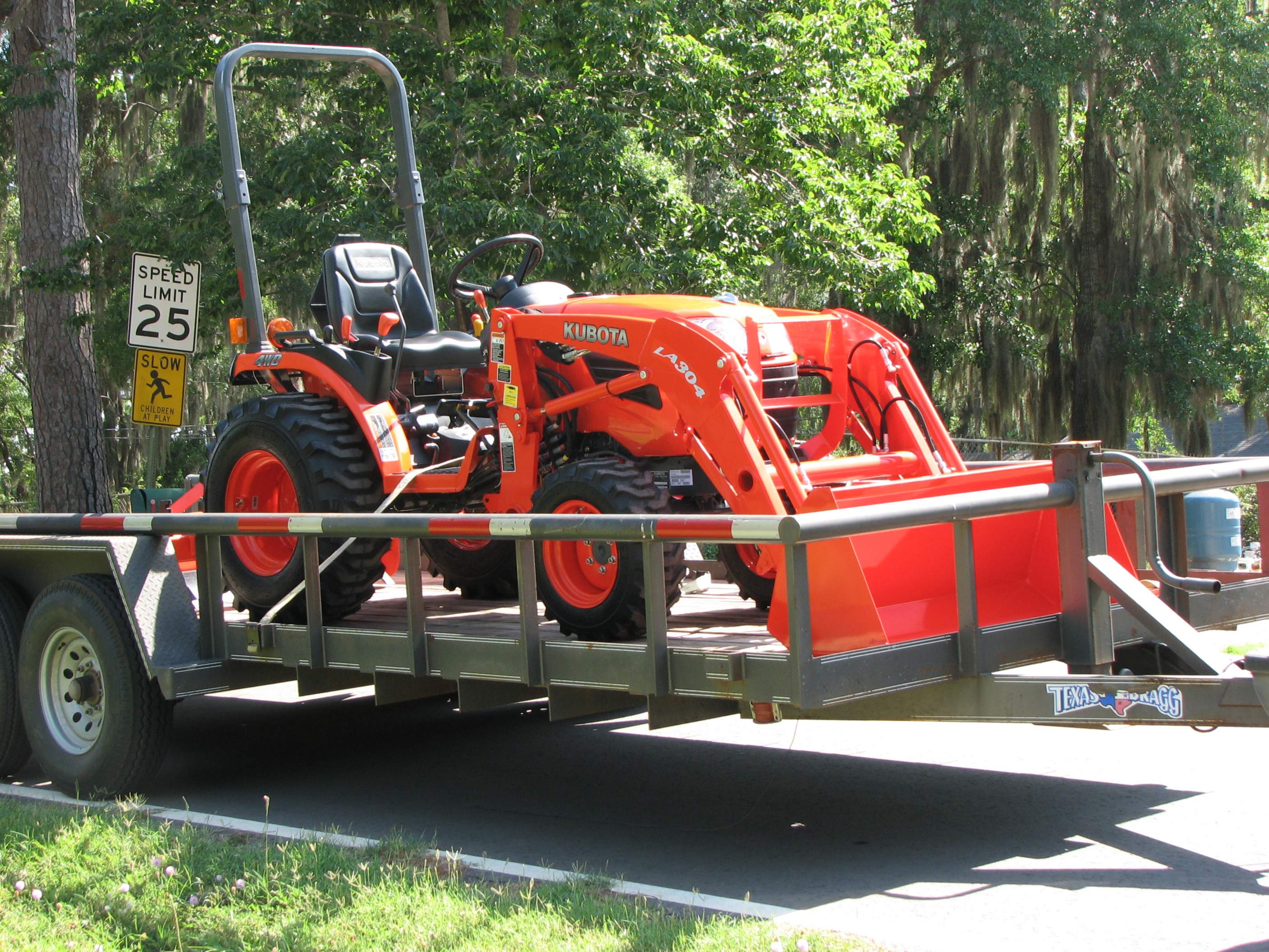

I have not towed my B2320 yet as my trailer is too small. But here is a picture of it being delivered by the dealer on a 18ft trailer. Yours is smaller than mine so just about even with the first tire should be close? tractor 003.jpg
