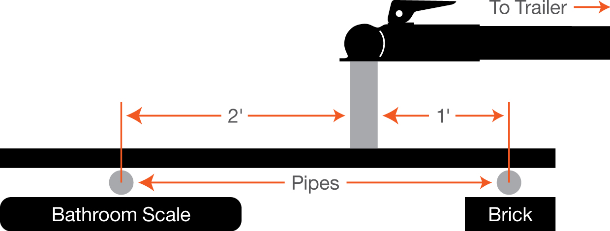

I am looking for a convenient way to measure my tongue weight, while adjusting my BX25 location and spare implement location on my 18' trailer. I have a 2" receiver hitch on my 2014 F150, and a (non-wheeled) trailer jack on the front of the trailer. If you think about the logistics, you would want to have the trailer attached to the truck while loading and/or adjusting the location of your load, but then you would have have to disconnect it and jack it up off the trailer ball in order to weigh the tongue weight. Also, since my trailer is a 7K model, I need a scale that can take at least 700 lbs, so your average bathroom scale is not going to work!
So, my fellow TBNers, any creative ideas that don't cost an arm and a leg would be much appreciated!
Use a fulcrum, staff and a bathroom scale.
Put the fulcrum 1' to the side of the trailer hitch.
Put a 10' staff (a 2x4 works) on the fulcrum and under the trailer hitch.
Put the bathroom scale 10' away, stand on it, lift the staff until the hitch raises off the ball.
Read the scale.
After subtracting your weight, if you have 80 pounds, multiply 80 times 10 (staff length) and the hitch weight is 800 pounds.

If you really need the weight, you could use a regular scale and a lever to reduce the scale weight. It'll take some math, but it'll get the job done.
